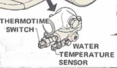

The gust of air from the fuel cap is normal. Could be fuel realated as Zedrally says, but when I had a similar problem with my 810 it turned out to be a bad connection at the temperature sensor. I cleaned the connector and the problem went away but I ultimately changed the connector since it was cracked and brittle as they all seem to get over time.
I'll work on the fuel filter and the temp sensor (assuming it's what my Haynes manual calls a water temperture sensor).

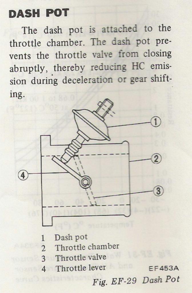

Another thought came to mind. I don't quite understand the full purpose of the DASHPOT. I had a racing engine, took it to a Nissan dealer, was told that no DASHPOTS were available, picked it up, then noticed the DASHPOT was on the seat. They removed it and I've been driving the car since with no apparent problems. What are the consequences of not having the thing mounted?
I'll have to look that up. (The daspot) I've never driven without it so I'll have to read up on it's function. The water temp sensor is the one on the right of the water neck with a two wire connector. It's smaller than the thermotime switch which is to the left.
Here's what I found in the 79 810 FSM. Apparently it's a emissions control device that works during deceleration and shouldn't cause any problems by not being there except allowing more HC emissions during deceleration. It was probably stuck which would cause your engine to race. Try some WD40 or your penetrating oil of choice on the shaft and see if you can make it move freely.
