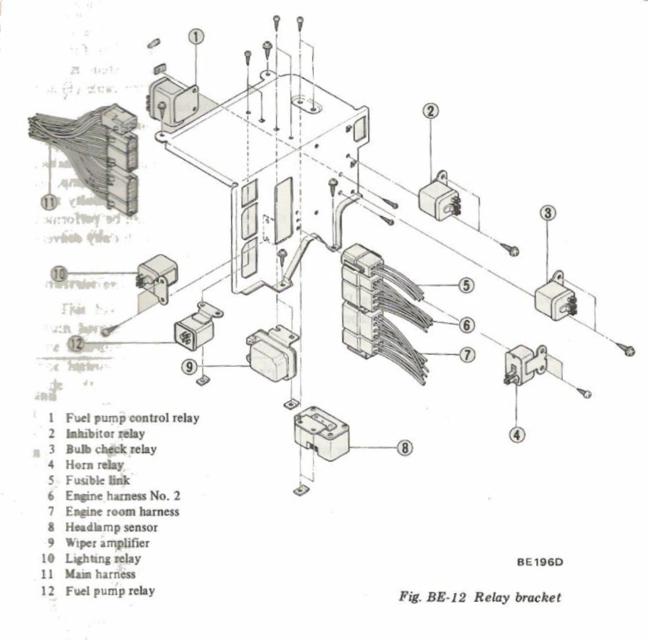

This presents a quote of a message posted by me back on PAGE 2. Relays entered my mind because of problems years ago. But I am totally ignorant about "relays'.
Another question while gathering information --
About 18 years ago, my 810 would die on the city streets, on the freeways, or on the interstates, not often -- maybe like every 2 or 3 months. It would not start unless I let it sit for about 20 mintutes. Nissan could not figure it out. A service rep even drove it back and forth to work for 2 weeks. Then I was told he couldn't get it to fail so the "computer chip" was replaced. That did no good. Finally it died and was impossiible for me start. I had it towed in and they said it was the relays. The intermittent problem I was having never occurred again. What are the relays, are they a simple part or something complex? Are they easy to obtain and install?
There is no 'computer chip'. Not in those days. All that tells me is that your Nissan tech didn't have a clue. That's par for the course, however, since many present day Nissan 'techs' were either small chidren or not even born in the era of the EFI L series engine. Relays aren't really complex. They either work or they don't. They can't be repaired. That is unless one posseses 'mad electrical skills'. There are test procedures for them in the FSM. As far as obtaining them, well, the junkyard is the only source I would know of. I doubt that Nissan still has them and I don't know if the ones for a 280Z or 280ZX are the same though they are available through places like MSA or Victoria British. I dread the day that I have to source relays for my 810. I haven't yet had a relay related problem in the 810 so I don't know much about the interchangability of relays from other Nissan models. When I first got the car, I opened up the relay box and ran checks on all of them and cleaned the terminals and plugs just as preventative maintainence. There is a relay box under the hood of the 810 right next to the battery. It houses the Fuel pump control relay, the inhibitor relay (A/T), the bulb check relay, the horn relay , the fusible link, the #2 engine harness, the engine room harness, the headlamp sensor, the wiper amplifier, the lighting relay, the main harness and the fuel pump relay. The ignition relay is above the fuse box on the kick panel on the passenger side.
