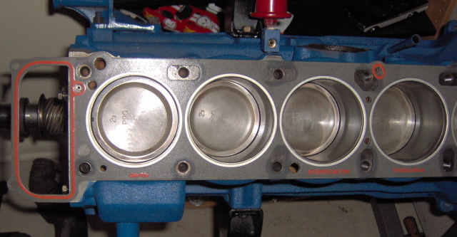

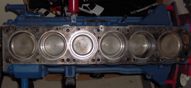

August 18, 200519 yr comment_134726 Brian, do the holes in the block you mention match any holes in the head? If there are holes in both I would not block them under any circustance. Sounds like the Nissan guy was being a d*** because you bought FelPro and not OEM Nissan. Just a thought but I'd check for the holes. Chris Link to comment https://www.classiczcars.com/forums/topic/16950-l28et-head-gasket-problem/#findComment-134726 Share on other sites More sharing options...
August 18, 200519 yr Author comment_134731 I don't see why they wouldn't. It is a turbo F54 block and P90 head. When I tore the head off the block during the begining, the gasket shredded. I could not get any numbers or even a product name. (I assume it was a Nissan one) The ports I am conserned (sp) about are all the small ones in the front and a couple that run down the sides. I'll have to post a pic later to clearify what I am seeing. Link to comment https://www.classiczcars.com/forums/topic/16950-l28et-head-gasket-problem/#findComment-134731 Share on other sites More sharing options...
August 18, 200519 yr comment_134736 Okay so I did some research on your F54 block, from this website. http://www.geocities.com/zgarage2001/z.htmlBryan Little says this about his own F54 build up "According to Nissan, L series head-gaskets should be installed dry (no sealer). I've tried a couple of head-gasket brands and I really like the Fel-Pro brand. It seals well, and as a bonus at rebuild it simply pops off the block, little scraping is necessary.I've seen comments that it's thinner than a stock gasket, and may increase compression slightly. I've also heard it may not seal well for turbo motors, but on regular motors I think it's ideal. I very lightly spread gasket sealer around the water jacket holes on the gasket. This keeps it from weeping coolant from the edges which is a problem on older motors" So I guess if you got the correct head gasket from FelPro then run it. If not, double check. Chris Link to comment https://www.classiczcars.com/forums/topic/16950-l28et-head-gasket-problem/#findComment-134736 Share on other sites More sharing options...

August 19, 200519 yr Author comment_134848 I went back to the parts store and showed the guy there my holes were being closed off. He says that it would be alright and that he uses all Fel-Pro gaskets in his car. "Some of the holes need to be blocked off so that the coolant circulates." I hope he is right. This is my first rebuild and I don't want anything to go wrong having waited all this time and spent all the money just to have detination and distruction to the engine. Here are some of the pictures I just took of it. 1) The block by itself 2) The block with the gasket on I hope you can see what I am talking about. Thanks. Link to comment https://www.classiczcars.com/forums/topic/16950-l28et-head-gasket-problem/#findComment-134848 Share on other sites More sharing options...
