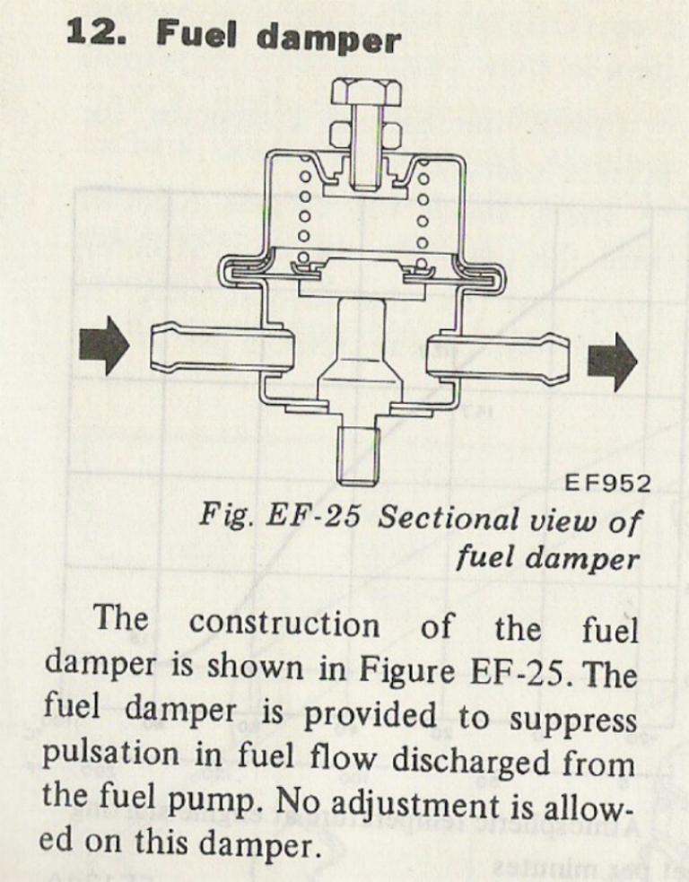

August 22, 200519 yr comment_135178 No, they dont get air locked. And there is no need to bleed them since the system is self priming. When you say 'inline fuel filter' do you mean the fuel damper? Thats not a filter. It's there to supress the pulsation in the fuel flow. The only filter back there is the small screen in the fuel pump outlet. Link to comment https://www.classiczcars.com/forums/topic/16969-car-wont-start/?&page=2#findComment-135178 Share on other sites More sharing options...
August 24, 200519 yr Author comment_135530 does the fuel damper look like a in line filter ? it had metal nipples and a glass cylinder to look through but it was so plugged i couldnt see through it i tried to blow through it but i olnly got alittle air through Link to comment https://www.classiczcars.com/forums/topic/16969-car-wont-start/?&page=2#findComment-135530 Share on other sites More sharing options...
August 24, 200519 yr comment_135531 If you blow though one side you should get resistance, blow through the other side and air should flow freely. It's metal with no glass. Look at the attachment. If someone replaced the damper with a filter, I would put a damper back in it's place. People have been known to add an additional fuel filter by the tank along with the damper. I personally don't think you need one back there (a filter). Link to comment https://www.classiczcars.com/forums/topic/16969-car-wont-start/?&page=2#findComment-135531 Share on other sites More sharing options...
