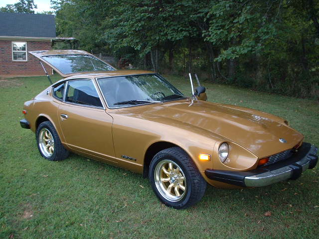

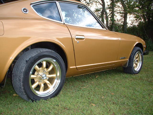

So here's my gold 280Z with those 15x7 Konig Rewind wheels in gold. I went with a 215x50x15 Kumho ECSTA tire and I must say I'm very pleased with the look and handling.

The Z and the wheels look great! Now don't take this personally, but man you have alot of space between the tires and fender well openings. Of course this is just my opinion, but if your Z was lowered at least and inch it would look closer to awsome! Take a look at my photo gallery and you will understand my point of view.
