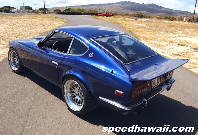

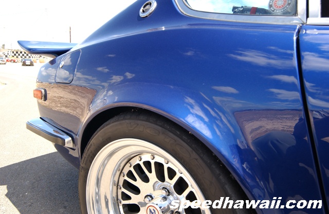

August 30, 200519 yr comment_136216 Not without flaring. I have 17x9.5 on all corners with coil-overs. Link to comment https://www.classiczcars.com/forums/topic/17090-whats-the-widest-rear-wheels-for-73-z-17-inch-i-can-run/#findComment-136216 Share on other sites More sharing options...

August 30, 200519 yr comment_136233 Curtis,Nice flares, may I ask if they were a custom fab or did you get them from somewhere?Dave Link to comment https://www.classiczcars.com/forums/topic/17090-whats-the-widest-rear-wheels-for-73-z-17-inch-i-can-run/#findComment-136233 Share on other sites More sharing options...
August 30, 200519 yr comment_136235 thehelix112 said: Curtis,Nice flares, may I ask if they were a custom fab or did you get them from somewhere?DaveCustom made steel flares (the front is stock). Link to comment https://www.classiczcars.com/forums/topic/17090-whats-the-widest-rear-wheels-for-73-z-17-inch-i-can-run/#findComment-136235 Share on other sites More sharing options...

August 30, 200519 yr Author comment_136308 oh and. curtis thats a great looking car.. Link to comment https://www.classiczcars.com/forums/topic/17090-whats-the-widest-rear-wheels-for-73-z-17-inch-i-can-run/#findComment-136308 Share on other sites More sharing options...

August 31, 200519 yr comment_136431 sphy1005 said: oh and. curtis thats a great looking car..Thanks.Curtis Link to comment https://www.classiczcars.com/forums/topic/17090-whats-the-widest-rear-wheels-for-73-z-17-inch-i-can-run/#findComment-136431 Share on other sites More sharing options...
