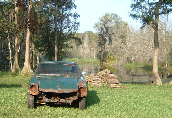

I bought a 72 240z sight unseen (my brother e-mailed me some pictures) a couple of years ago from 500 miles away, I brought it home on a flatbed. The price was right, 600 bucks. I told him that if it looked ok, and the rails, & floorboards were good I wanted it. He told me it had an uncracked dash (which has since cracked) so I bought it. Now im not so sure.
From a previous life I knew it would need some work, quarter panels (which I have purchased) fenders (I have one, need another). Interior etc... its a project, needless to say. It is slowly coming along (way slower than the first one I bought.)
my stalling point is a hole underneath the drivers side fender (bottom by the door where you bolt the fender on from the bottom) is rusted pretty bad. This is on the side of the firewall? not the bottom of the car. The fender is going to the scrap yard if I ever get it off, so and I am not concerned about that. Just the structure of the car. I hope to post pictures here in the coming weeks for clarification.
It is rusted to point that if I try and remove the bolt closest to the door to get the fender off, the piece of the frame or body is going to come with it. Pretty big hole.
Further in, the frame rail and floor board is good, just this area is bad (softball sized hole). Does anybody have experience or even better pictures of repairs to this area?
I know on a unibody frame, everything is important (even the windshield) but is this a repareable area?
