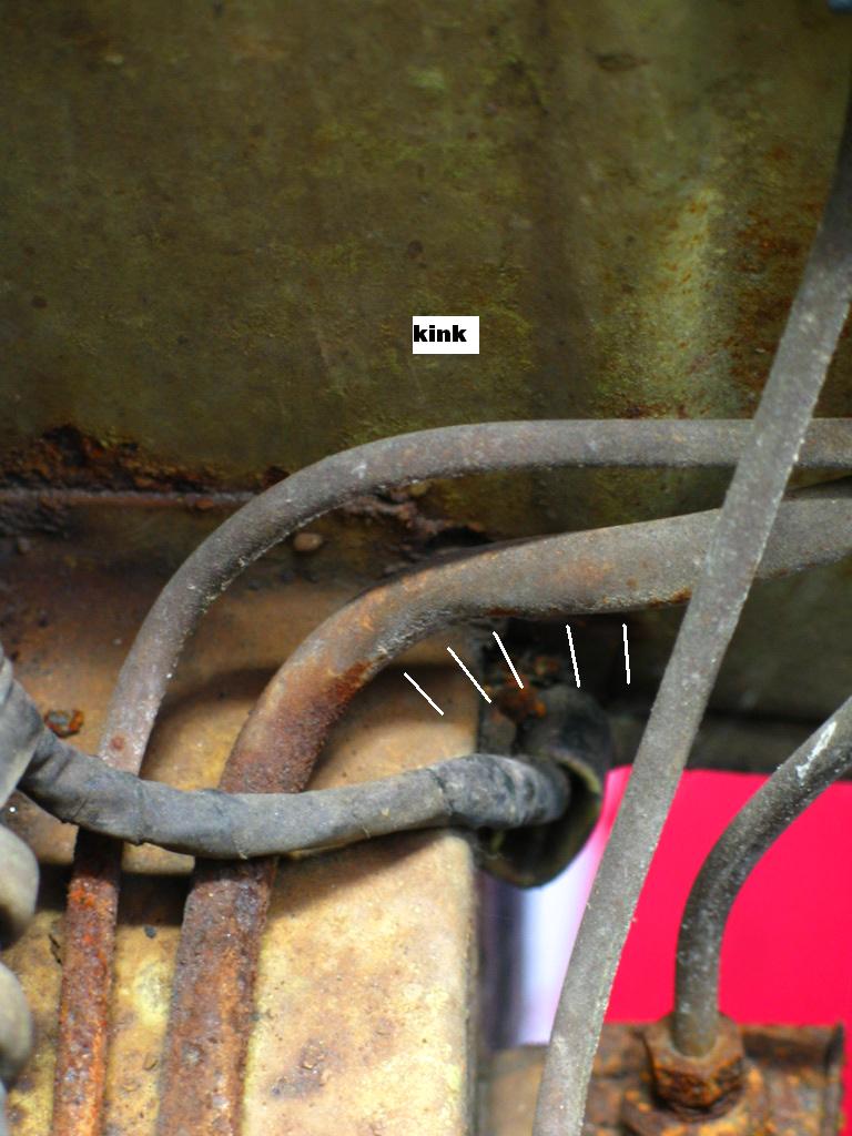

Posted August 30, 200519 yr comment_136296 Greetings, all! I am looking into replacing the hard fuel lines for my Z. They appear corroded, the fuel line filter housing has a rusty tone to it (orangier than normal gas) and actually the intake line appears to be out-of round as it enters the engine bay (see pic. Looks to me like it could cause fuel delivery problems). I am already doing rear end/undercarriage work, and was planning on replacing the hard brake lines (rusty colored brake fluid after 200 miles!) anyway, but I cannot find a source for fuel lines. Classic tube sells the brake line set for $225, but not the fuel lines (the one from tank to filter appears to be 5/16" while the others are more like 1/4" or 3/16"). Prices at local Nissan dealer (IF he can get them) is like $60 per line--a little steep. Has anyone done this? Found a good source? Bent their own? Archive search yields a lot of talk about vent hose repair, but not fuel line replacement. Thanks, Steve Link to comment https://www.classiczcars.com/forums/topic/17095-replacement-fuel-lines-source/ Share on other sites More sharing options...

August 31, 200519 yr comment_136358 Bend your own, take the old one off carefully, and use it as a guide for some stainless tubing, put in a little larger if you want-to allow for upgraded fuel delivery later-and double flare it-the tubing and fittings for total replacement(brake lines and all) will be less than $150, and you will have no further corrosion worries with stainless.Will PS straightening coiled tubing is supprisingly easier than I thought it would be. Link to comment https://www.classiczcars.com/forums/topic/17095-replacement-fuel-lines-source/#findComment-136358 Share on other sites More sharing options...

August 31, 200519 yr Author comment_136362 Bend your own, take the old one off carefully, and use it as a guide for some stainless tubing, put in a little larger if you want-to allow for upgraded fuel delivery later-and double flare it-the tubing and fittings for total replacement(brake lines and all) will be less than $150, and you will have no further corrosion worries with stainless.Will PS straightening coiled tubing is supprisingly easier than I thought it would be.Will:Never done this before....any tips about flaring? Thanks, Montoya fan. Inline Tube appears to carry the right sizes, i just need to figure out the right fittings. Any ideas?Thanks again for the help,Steve Link to comment https://www.classiczcars.com/forums/topic/17095-replacement-fuel-lines-source/#findComment-136362 Share on other sites More sharing options...
