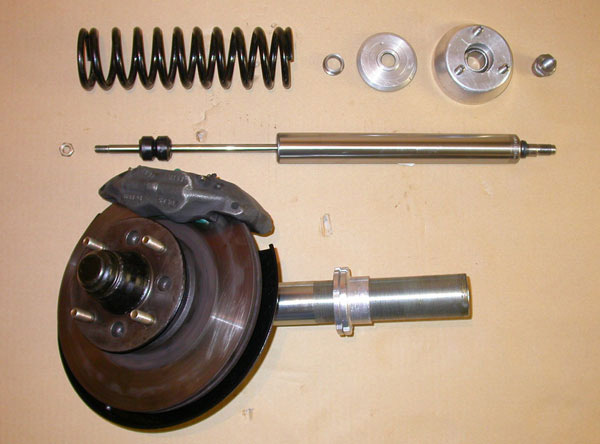

Here's a pic of the components on my car.
That's a Peugeot 306 / 505 GTI vented disc, used in conjunction with the Nissan Sports Option Sumitomo "MK63" 4-pot caliper.
You have to re-drill the PCD for the hub mounting bolts, but other than that its a bolt-on job.
