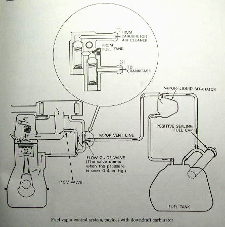

i studied your diagram and it makes sense to me that the PCV and vapor system would only help fuel efficiency and not really hinder engine performance
is this true? or does it hinder performance? if so how much?
does this system cause the dreaded vapor lock i keep hearing about?
Vapor lock is typically caused by the high underhood temperatures that the lean mixture of the flat-tops create.
PCV and vapor systems have no measurable effect on performance or driveability.
