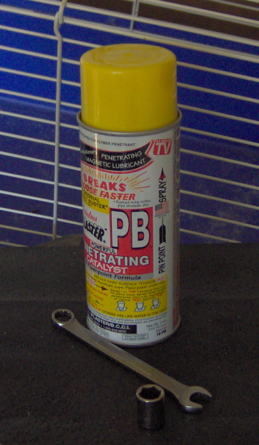

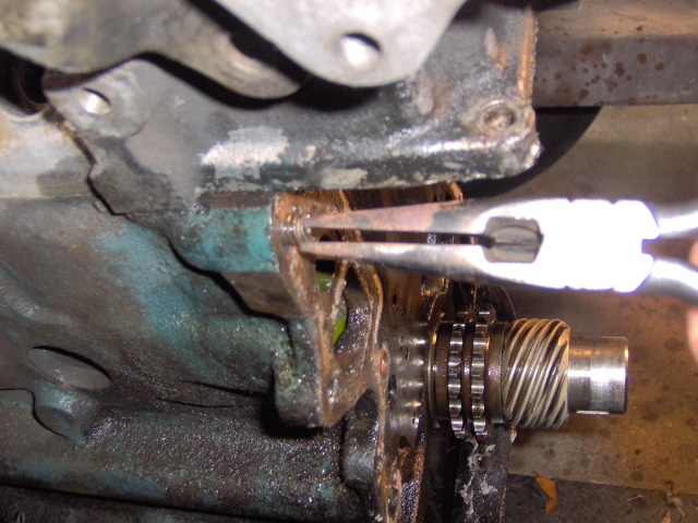

October 1, 200519 yr Author comment_140133 I got the bolt out!!! I sprayed the PB first and waited for 5 min. When I started to hit it with the EZ out, it moved. Got the rest with the pliers, like butter. Lady J will be back on the road by next weekend!! Special thanks to LanceM, seerex, cremmenga. Much appreceated. Link to comment https://www.classiczcars.com/forums/topic/17286-snapped-alternator-adj-rod-bolt-in-block/#findComment-140133 Share on other sites More sharing options...
