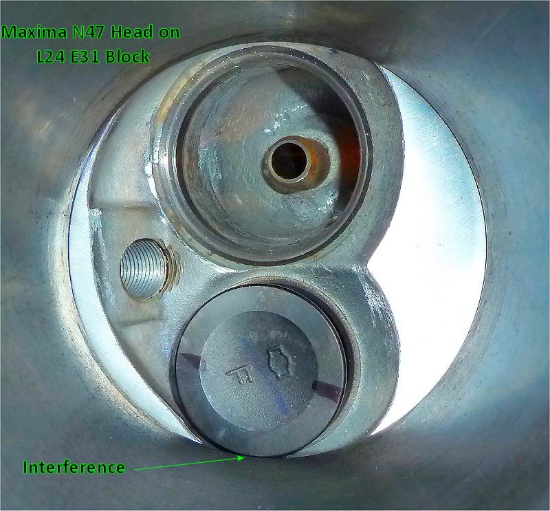

Just finishing machine work on a rebuild. I took a fun photo of the combustion chamber from where the crank sits:
I am notching the block with a hand file as my better half drove to work with my die grinder in the back (My fault :)
The head is a stock N47 from a Maxima.
The block is an E31 from a Jan 1971 240z
I figured I would add to this older post to help others who have recently searched as I have for these details

It can easily be done with a Dremel and grinding attachment. Do it before you get the block honed to prevent contamination and put several layers of tape on the top of the block in case the Dremel rides off across the top of the block.
