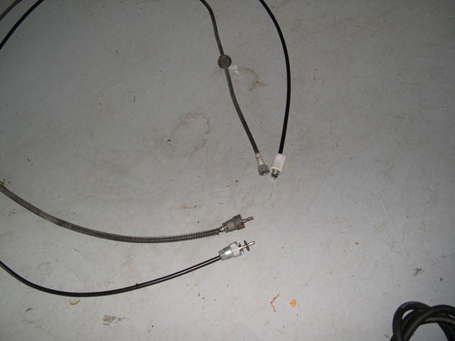

i am having trouble replacing my speedo cable for my 1970. I know the speedo started at 20 for 1970, but is there a difference between the 70 and 71 cable. I ordered a new one from VicBritish and the one they sent had different ends. Can someone help me with this? My old one is the one on the inside
https://www.classiczcars.com/forums/topic/17360-speedocable/
Yes, this was the one that came off the car. Unfortunately, i cant find a replacement.
As far as I know, the one on the inside of this photo with the wire spring wrapped around the end which "plugs" into the transmission is correct and should be original for your 240-Z.

Get the correct part number and try http://www.nismoparts.com. They pull from several Nissan dealers. I got a a/c expansion valve for a 1979 810 from them when no one else could find it. If anyone can get it, they can.
EDIT: The part number for a 70 240Z speedo cable according to the a customer service rep at nismo is B5050-N4701
