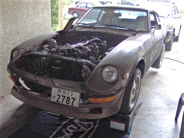

October 2, 200519 yr comment_140150 Here's my old MSA air dam.. DUCTED taped to the front.. haha Link to comment https://www.classiczcars.com/forums/topic/17413-msa-air-dams/#findComment-140150 Share on other sites More sharing options...
