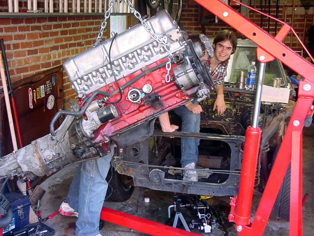

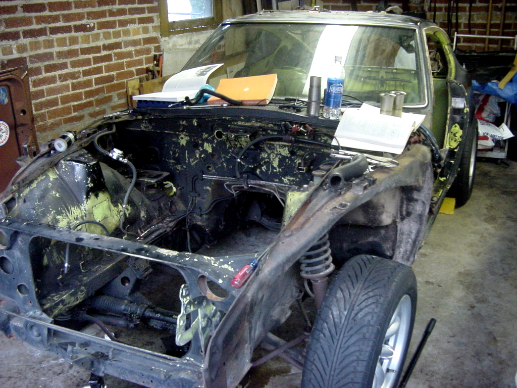

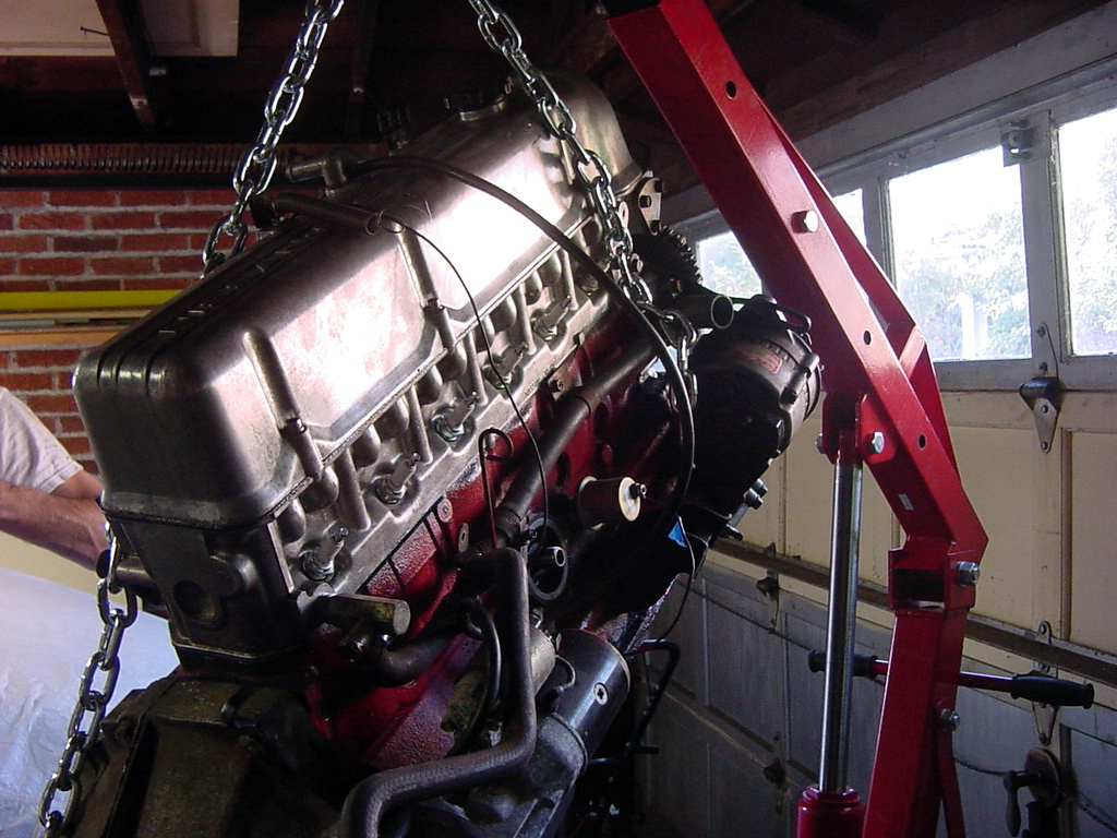

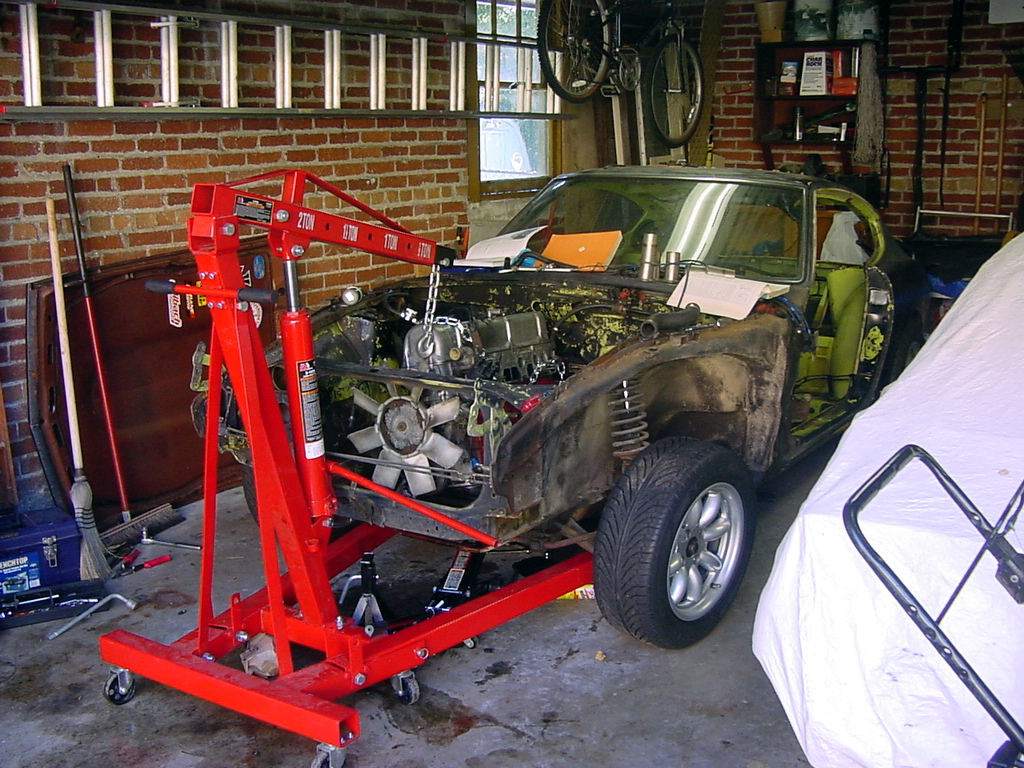

September 28, 200519 yr Author comment_139805 Thanks for the help, it's very much appreciated. I brought up the front of the car from the center, and slid the engine lift under. I, like ken, had to close my garage door to allow the lift to go up all the way. That baby came out no problem. I'm now in need of an engine stand, there was one at advance auto for about thirty, I don't know if it was any good. Anyways, thanks again. Here are some pics Link to comment https://www.classiczcars.com/forums/topic/17416-lift-doesnt-fit/#findComment-139805 Share on other sites More sharing options...
