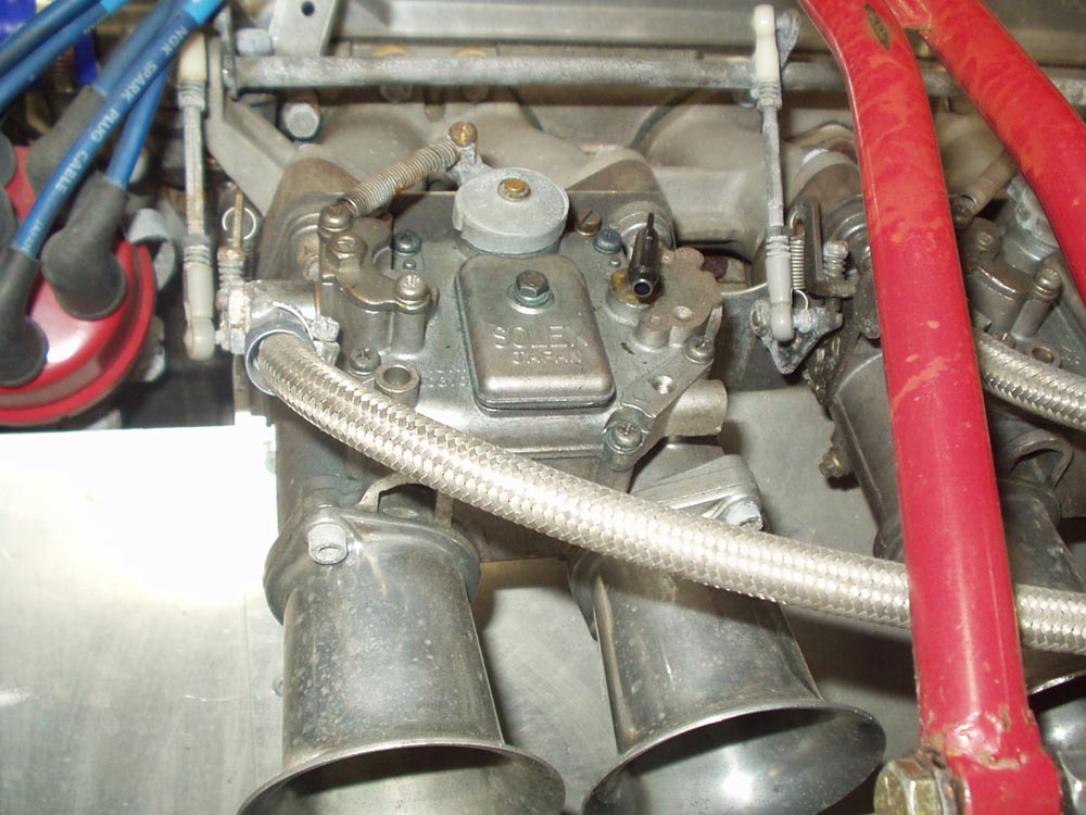

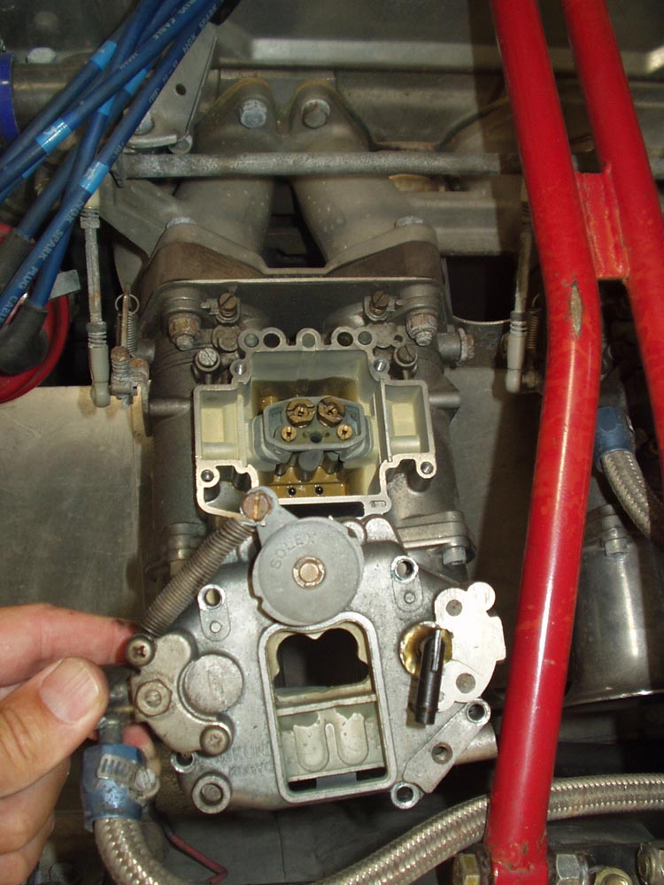

October 8, 200519 yr comment_140991 Here are a couple of pictures of my carb vents... It's the little black L tube to the right of the jet cover. I also included an internal shotvso you can see the baffle. This was all done by Rebello and I can't fully explain how it improves things, but it does seem to work! (as is evident by the blue tint of the race gas on the carbs) Tom Link to comment https://www.classiczcars.com/forums/topic/17456-duel-fuel-pumps/?&page=2#findComment-140991 Share on other sites More sharing options...

October 10, 200519 yr comment_141157 Here are a couple of pictures of my carb vents... It's the little black L tube to the right of the jet cover. I also included an internal shotvso you can see the baffle. This was all done by Rebello and I can't fully explain how it improves things, but it does seem to work! (as is evident by the blue tint of the race gas on the carbs) Tom Thanks for the photos. It looks like they did in fact epoxy shut the bowl holes as well. Link to comment https://www.classiczcars.com/forums/topic/17456-duel-fuel-pumps/?&page=2#findComment-141157 Share on other sites More sharing options...
October 10, 200519 yr comment_141158 Oh yeah! That's the ticket! I wasn't even looking down there. The vent holes under the jet cover are epoxied shut. Ya see what happens when you let other people fix things for you? You miss out on the details! Tom Link to comment https://www.classiczcars.com/forums/topic/17456-duel-fuel-pumps/?&page=2#findComment-141158 Share on other sites More sharing options...
October 10, 200519 yr Author comment_141161 So the idea is to have the vent hole in that baffled compartment.I wish I had a better grasp on the sidedraft carb situation.This is classic black magic story of who really knows how and why it works. Link to comment https://www.classiczcars.com/forums/topic/17456-duel-fuel-pumps/?&page=2#findComment-141161 Share on other sites More sharing options...
October 10, 200519 yr comment_141164 So the idea is to have the vent hole in that baffled compartment.I wish I had a better grasp on the sidedraft carb situation.This is classic black magic story of who really knows how and why it works.Jetting may fall into the "black magic" realm but this is pretty straight forward, or at least to me. Basically the holes which are epoxy'd shut were originally the vent holes for the float bowl. This simply keeps the bowl from being pressurized and allows fuel to flow in. What happens under high g-load right handers is the fuel sloshes over to that side, comes up through the holes and then flows over on top of the jets. This causes an extreme rich situation because the air jets are being blocked off completely. Link to comment https://www.classiczcars.com/forums/topic/17456-duel-fuel-pumps/?&page=2#findComment-141164 Share on other sites More sharing options...
