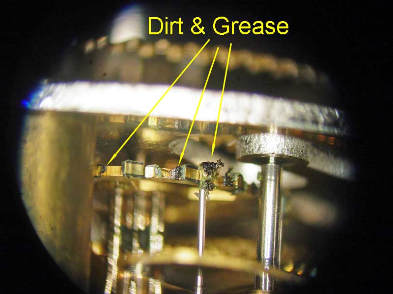

The attached photo goes to the post I made in 2005. This is what oil does to the gears in the 240 mechanical mechanism.
If you can remove all the contamination as shown you have a chance of getting the clock to work , that is if the motor is good.

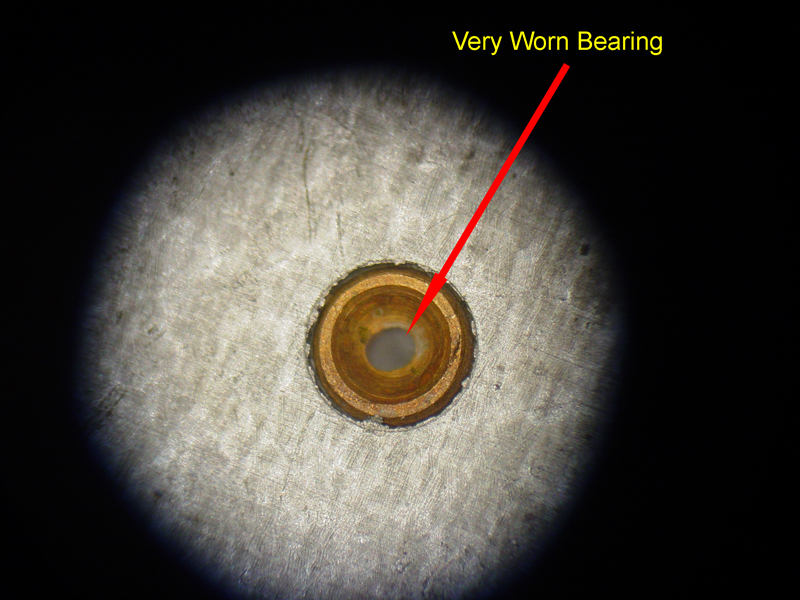

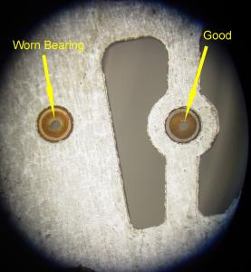

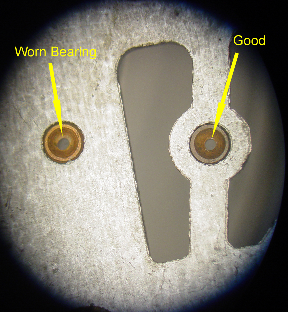

Another problem I have seen lately is that the bearings, and there are about 5, can become worn and cause problems. What happens is the shafts attached to these bearings will start to wobble and the associated gears bind and lock up.
Again the wear is associated with the oil that attracts the dust and dirt and reacts like sandpaper on the bearings / rotating surfaces. Replacing the bearing(s) is the only solution. These are very small and difficult to work on.

The original article I wrote was for the 240 clock which is 98 % mechanical and has no electronic ckt .Oil / contaminants are the main failure cause.
Oiling any of these clocks is a NO-NO. There are metal and nylon (self lubricating) gears in all the clocks. Oil only causes problems unless you want to pull your clock every 6 months for cleaning and re-oiling.

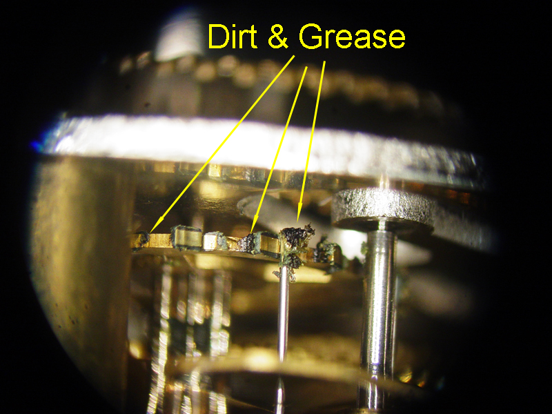

Deoxit is basically a contact cleaner and should work. However, most of the 240 mechanisms I have seen look like the attached  photos . Most cleaners are not aggressive enough to remove all the grease, oil, and dirt. The other problem is bearing wear . The best way is to completely disassemble the clock , clean , and inspect for damage.
Hope this helps
