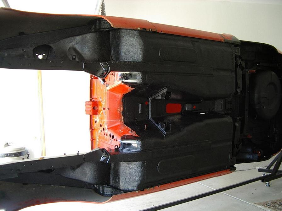

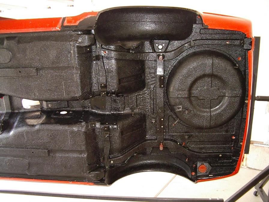

First I gave her belly the POR treatment. I topcoated the wheel arch areas and the trans tunnel. Then I took some tape and taped off the areas that I didn't want covered with bedliner. The list is long but if you've come this far then you know what needs to be protected and what needs to remain clear. Then I went over to Autozone and bought Herculiner it's a roll on bed liner. Same product as the spray on. But by rolling and using a brush I could apply it where it needed to be. No mess, no overspray, no plugged holes. I applied an extra thick coat (1/8") in the wheel wells and trans tunnel. Everywhere else got a single application. I went through 1 gallon and 1 qt.
Oh yea, buy some corks from your local hardware store to plug the drain holes. Wrap a piece of tape around it then plug the hole.

That is exactly where I am! Por15 on-and where to go from there! I asked the question to get some help with what to use next. Herculiner was the product I had in mind-for the exact same reasons Ed outlined. I had a spray in liner put in the truck the day after I bought it. I will research a little more before I coat the underside.
