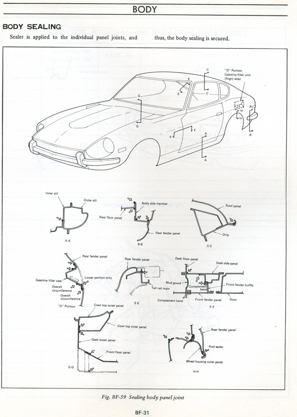

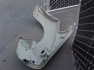

October 30, 200519 yr comment_143700 Her Majesty the 26th has had her doglegs lifted twice, but please don't leak this to the tabloids. She now relys on the royal house of TABCO for her replacement panels. http://www.rustrepair.com/repair_panels/onlinecat.htm?r=ru&p=sm-datsun The reason that area takes it so hard is because the seams of the various panel shapes EScanlon is talking about are not sealed properly. As he points out, several panel shapes come togeather in this area. They are spot welded and the seams are filled with sealer. The old sealer dries and cracks. And to make this a real slap-in-the-face, the juncture gets wet just at the thought of enjoying the ride! Good luck! Find yourself a good metal surgeon and weld yourself back to clean rockers. And now that you are going to paint your car, take the time to clean out the seams and seal them back up. I have been using 3M 08300 Ultra Pro Sealant. CW- Link to comment https://www.classiczcars.com/forums/topic/17794-what-is-this-area-called/#findComment-143700 Share on other sites More sharing options...

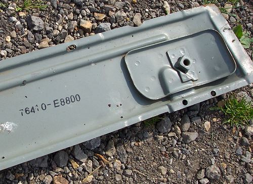

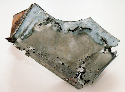

October 30, 200519 yr comment_143702 Here are a few more shots that may be of help. The fender metal covers the joint between the floor and the rocker just below the door post. Inside of the rocker at the end where the seat belt mount is. "...thus, the body sealing is secured." Link to comment https://www.classiczcars.com/forums/topic/17794-what-is-this-area-called/#findComment-143702 Share on other sites More sharing options...
