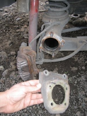

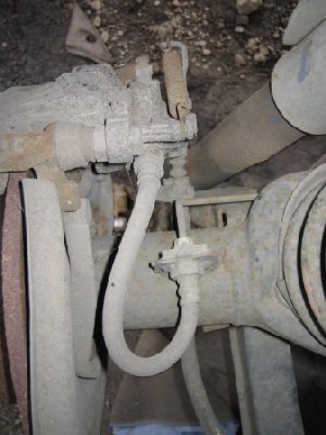

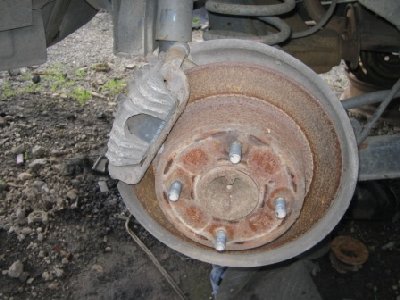

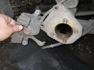

December 28, 200618 yr comment_194046 I took some photo's of the R31 Skyline/Pintara rear brake set up as I was pulling it from the car at 'Pick a Part'. Link to comment https://www.classiczcars.com/forums/topic/17812-rear-disc-brake-conversion/?&page=2#findComment-194046 Share on other sites More sharing options...
