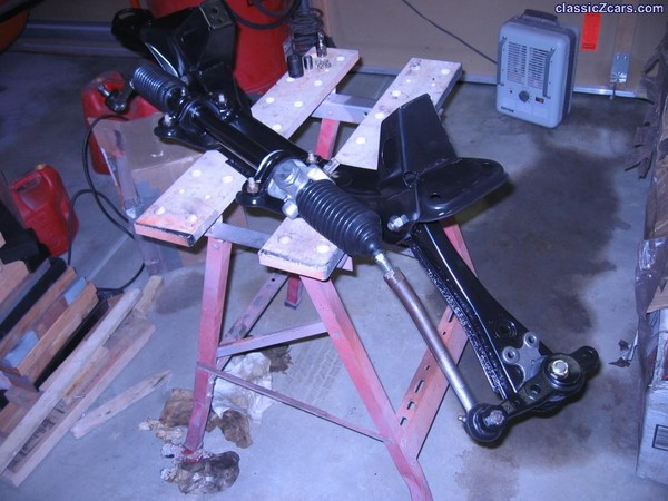

November 11, 200519 yr comment_145619 :knockedou Here are a couple of pics from my gallery, showing the steering rack assembled to the cross member with new urethane bushings. This is on my '73, should be the same as your '71. :rambo: Link to comment https://www.classiczcars.com/forums/topic/17893-steering-rack-bushing-problem/?&page=2#findComment-145619 Share on other sites More sharing options...
