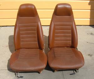

January 14, 200619 yr comment_152034 I just ran across a '76 280Z in a salvage yard, the seats in it still had the vents. I have a '73 and neither seat has the vents. So, I don't know if these are original or if they've been replaced/reupholstered by a PO. I'd be pretty sure they were reupholstered by a PO. There are/have been a lot of aftermarket covers that look about right, just no vents. See photo. Chris' date=' my 72 Chassis & Body Service Manual mentions changing from the standard seat to the reclining seat on page BF-27. At the top of the page it says, "The reclining seat back is furnished as an option. Reclining the seat can be made by attaching reclining device instead ofthe device for standard seat." It doesn't mention if the option is available for both seats. My car has a lever for reclining the seat on the drivers side, but not on the passengers side. Do you happen to know when the reclining option first became available?[/quote']Not Chris, but I always heard it was the '72 model year. --My 73 has the recline lever for the passenger side as well, as did my '72. Steve. Link to comment https://www.classiczcars.com/forums/topic/17941-1st-gen-seats/?&page=2#findComment-152034 Share on other sites More sharing options...

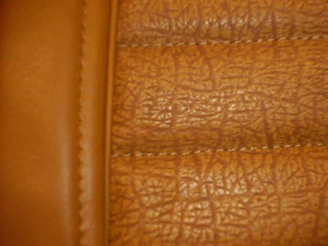

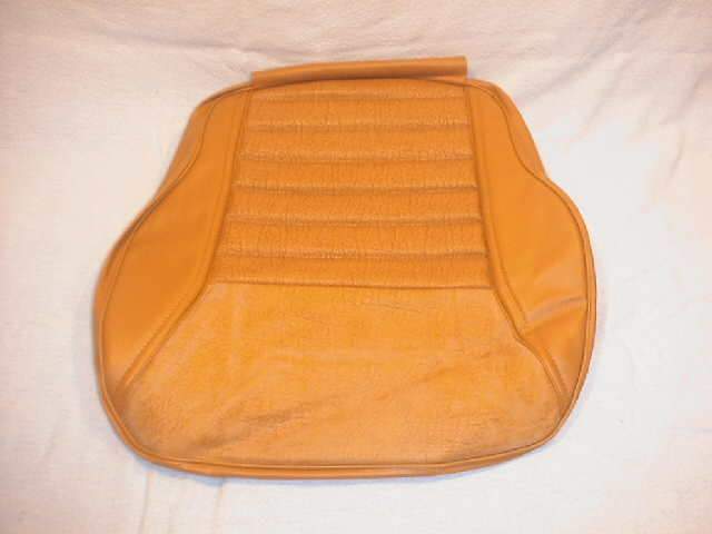

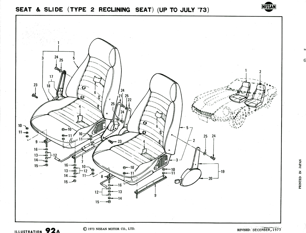

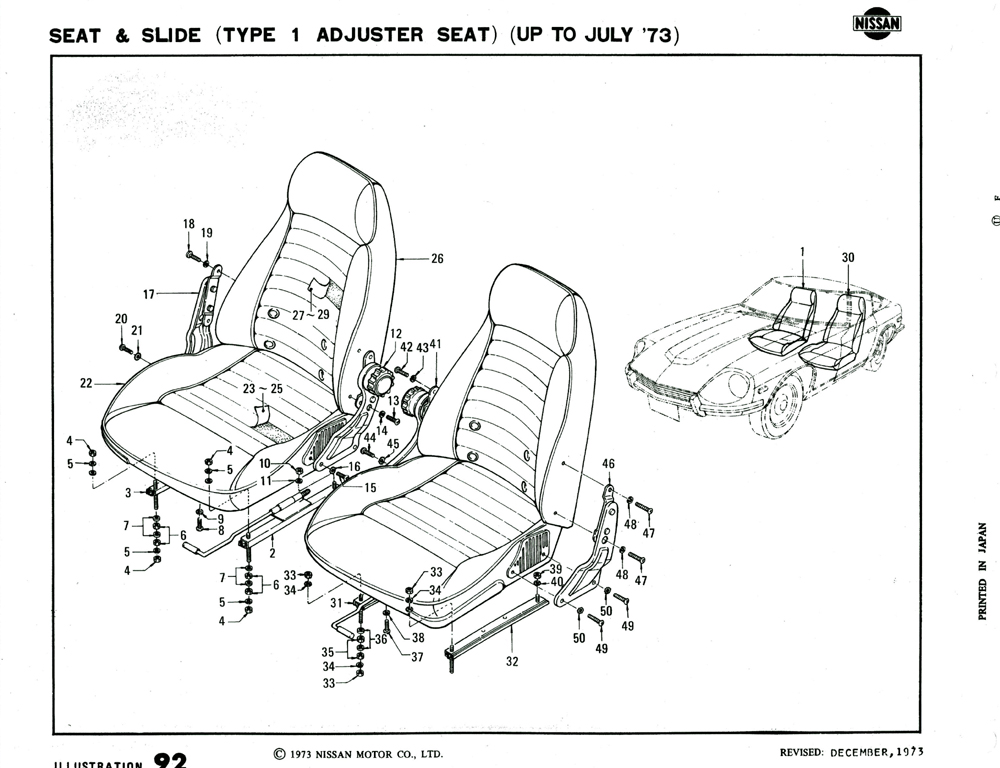

January 14, 200619 yr comment_152053 Shame on you guys for not getting out your parts books and looking this stuff up! Just comparing the black seats; the type 1 seat is listed up to 12/71 however the type 2 seat is listed up to 4/71 and from 5/71. I believe the type 2 seat was available as an domestic option, thus our import change around May of 71. They both came with four branding irons in the locations shown. The next seat change for the American market came in August 73. I found it interesting that the parts catalog doesn't say squat about the seat frame, springs, or webbing. Huh? Nova, your Fairlady could have a type 2 seat or a type 1. If you think it is a ZL model (I think we bantered it around some months ago, didn't we?) then the type 2 recliner seats would probably be correctest. Here are a couple of pictures of upholstery texture samples. The part number is in the file name. ZOOM-ZOOM Link to comment https://www.classiczcars.com/forums/topic/17941-1st-gen-seats/?&page=2#findComment-152053 Share on other sites More sharing options...
