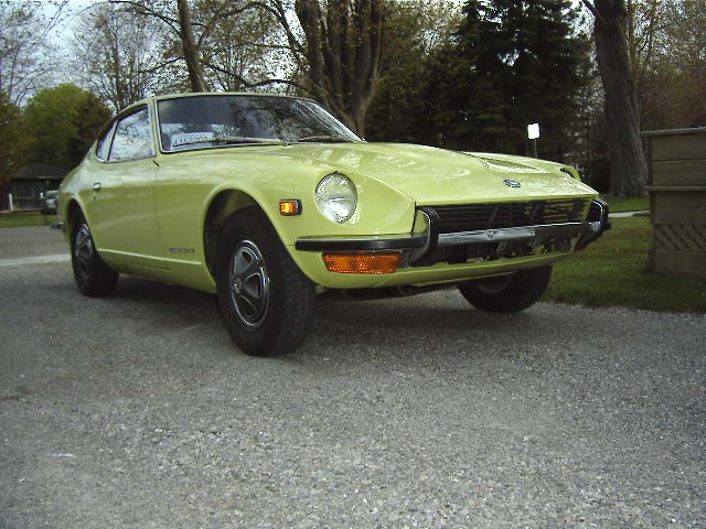

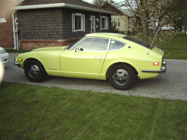

yea,paint is original. i talked to the original owner's wife.(husband deceased) she told me everything was original and nothing done to car except mantenance.always garaged(from cali) and the paint is still very shiney
