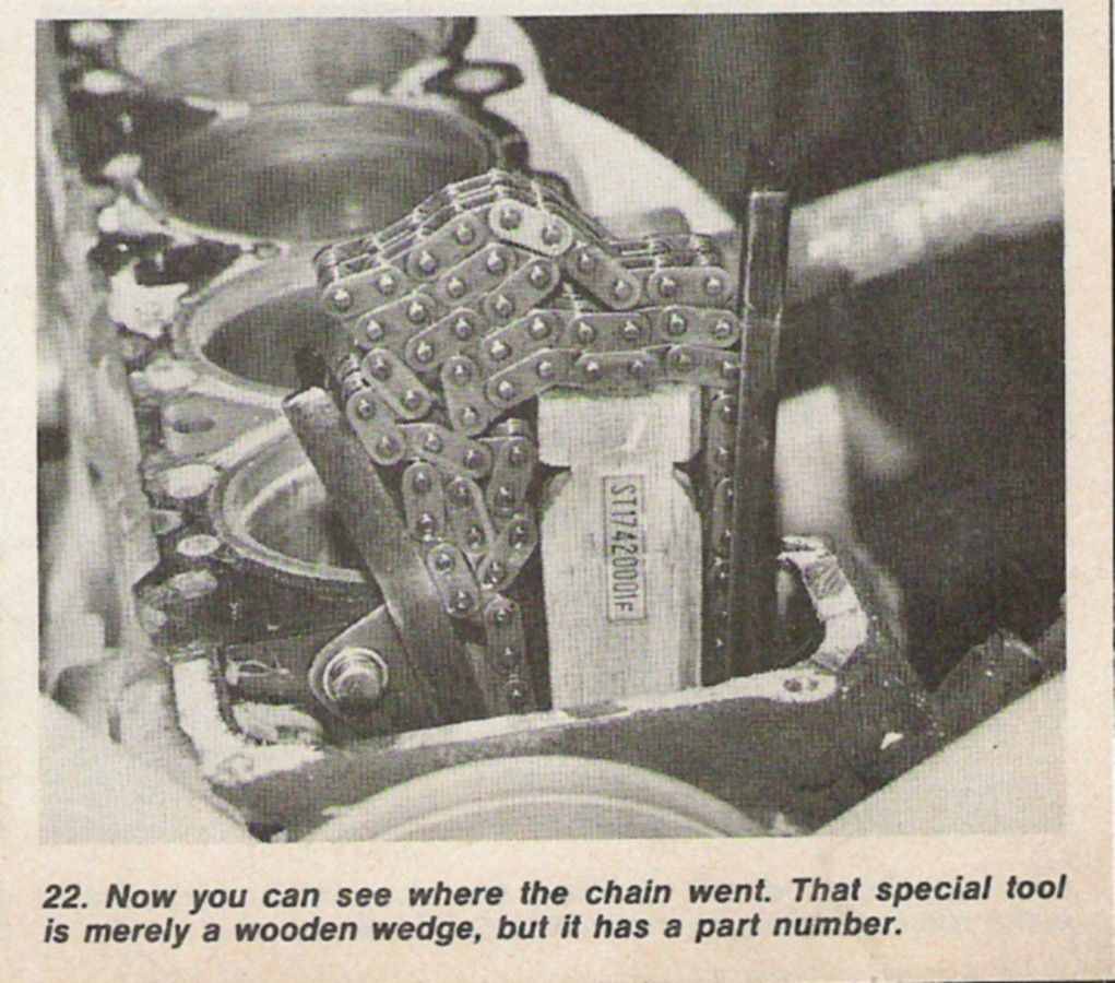

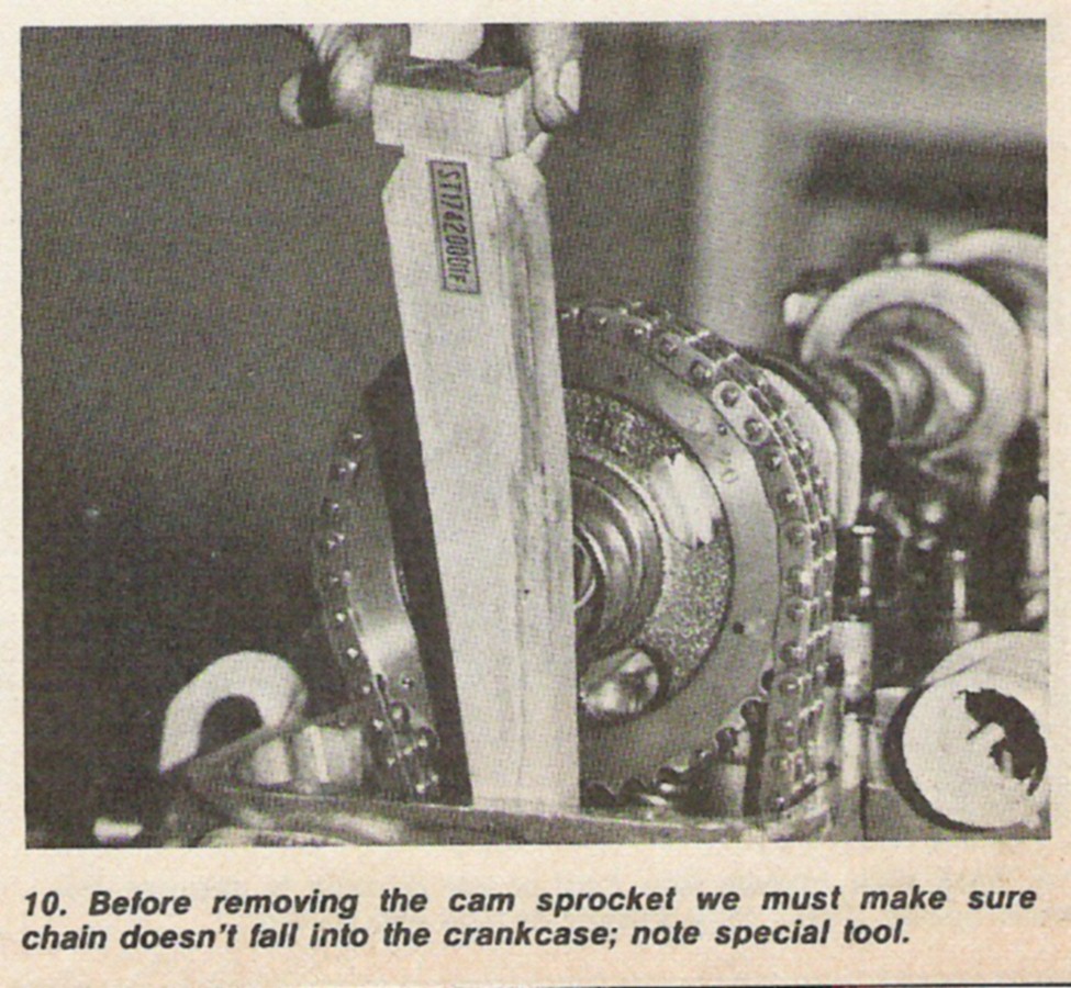

November 19, 200519 yr comment_146510 We talked about this in another thread a couple of years ago. These pictures show how to wedge the chain to prevent having to remove the front cover. I doubt if you can still get the wedge from Nissan but I made the one I use from a piece of wood years ago. Link to comment https://www.classiczcars.com/forums/topic/18068-sorry-about-this-but-i-just-have-to-ask/?&page=2#findComment-146510 Share on other sites More sharing options...

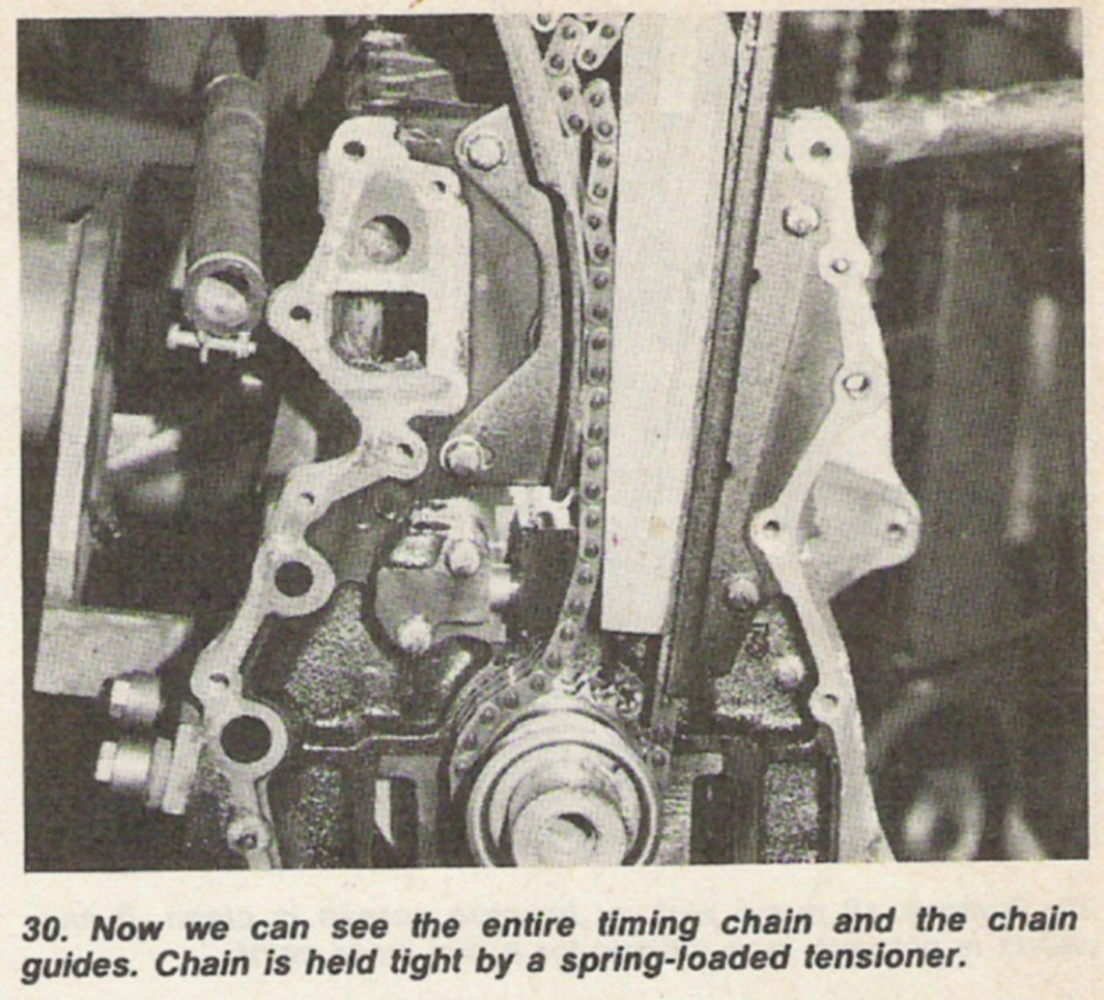

November 19, 200519 yr comment_146511 This next one shows how the wedge works but you wouldn't actually see this since the purpose of the wedge is to prevent having to remove the cover Link to comment https://www.classiczcars.com/forums/topic/18068-sorry-about-this-but-i-just-have-to-ask/?&page=2#findComment-146511 Share on other sites More sharing options...

November 19, 200519 yr comment_146563 Well, after going out and taking a look, Maybe I got lucky and it didn't spring. Here is a picture. Yes, im sorry to say that's a coat hanger.Just keeping the chain from falling down isn't good enough. Unless you wedged something down between the chain links you're out of luck. When I was 18 and tried the same thing you're doing I did wedge a block in there but I must not have gotten it tight enough. The tensioner popped out a little bit because I then couldn't get the cam sprocket back on the camshaft without a bit of force. A few days later while driving the tensioner broke, the chain slipped, and all of my exhaust valves got bent. Link to comment https://www.classiczcars.com/forums/topic/18068-sorry-about-this-but-i-just-have-to-ask/?&page=2#findComment-146563 Share on other sites More sharing options...

November 22, 200519 yr Author comment_146774 So It looks like I have sprung the tensioner. Do I reset it by removing the front of the engine or can I go in from the oil pan. Is one easier than the other? Link to comment https://www.classiczcars.com/forums/topic/18068-sorry-about-this-but-i-just-have-to-ask/?&page=2#findComment-146774 Share on other sites More sharing options...
November 22, 200519 yr comment_146782 So It looks like I have sprung the tensioner. Do I reset it by removing the front of the engine or can I go in from the oil pan. Is one easier than the other?You have to remove the front cover. I don't think you'd be able to get to it through the oil pan any easier than you could get to it from the top. Link to comment https://www.classiczcars.com/forums/topic/18068-sorry-about-this-but-i-just-have-to-ask/?&page=2#findComment-146782 Share on other sites More sharing options...
