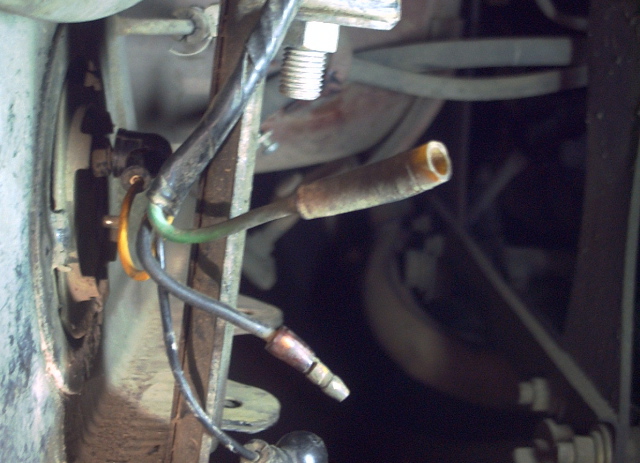

3. There are two wires near the sending unit leads which are attached to nothing (see attached photo). One is green/female, one is black/male. What is their purpose?
The two wires mentioned in item 3 of your post are for an electric fuel pump. My '73 has an electric pump mounted back by the fuel tank, but I don't think earlier years had the electric pump, even though the wires are included in the harness.

From what I know, the '73 240Z's had two fuel pumps: an electric pump mounted back by the fuel tank, and a mechanical pump mounted on the cylinder head. I think the electric fuel pump was added to help with vapor lock problems on the '73.
Perhaps someone more familiar with this can add details?
