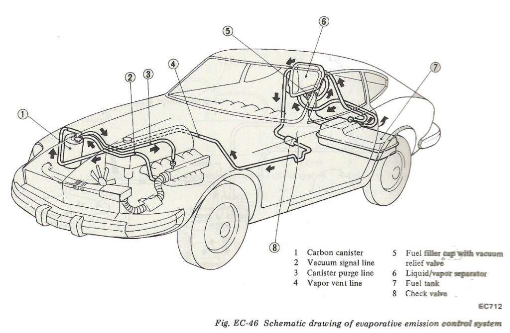

not sure if thid is in teh rigth place, or even if i named it right, but what the hell is this thing for? mine has 3 outlets on it...but one was open with no hose on it so i put a stopper on it.

The three hose connections are distributor vaccum, purge, and tank. It just another part of the emissions control. The distributor V C hose gets a vacuum signal from the distributor, the purge hose goes to the intake manifold and the tank hose goes to a check valve and then to the liquid/vapor seperator (sometimes called expansion tank) in the right rear quarter panel. I don't know the mileage interval for changing the filter but if it looks good, I leave it, and if it's dirty I clean it and put it back in. The FSM says 30000 mi or 24 months.
