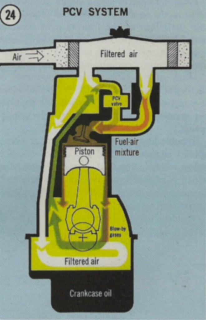

November 27, 200519 yr comment_147466 Quote from the service manual: The PCV system, used on all models, routes crankcase fumes into the combustion chambers for burning.Fresh air drawn from the air cleaner housing scavenges emissions (e.g., piston blow-by) from the crankcase, then the intake manifold vacuum draws emissions into the intake manifold. They can then be reburned in the normal combustion process. Link to comment https://www.classiczcars.com/forums/topic/18167-pcv-valve/#findComment-147466 Share on other sites More sharing options...
November 27, 200519 yr Author comment_147495 curse you! where did you get a color guide? mines all black and white.... Link to comment https://www.classiczcars.com/forums/topic/18167-pcv-valve/#findComment-147495 Share on other sites More sharing options...
November 27, 200519 yr comment_147498 curse you! where did you get a color guide? mines all black and white.... That's from Clymer's Datsun 810 1977-1980 service manual. It has a lot of nice charts and diagrams but when it comes down to information, I'll take the FSM over any of them. Link to comment https://www.classiczcars.com/forums/topic/18167-pcv-valve/#findComment-147498 Share on other sites More sharing options...
