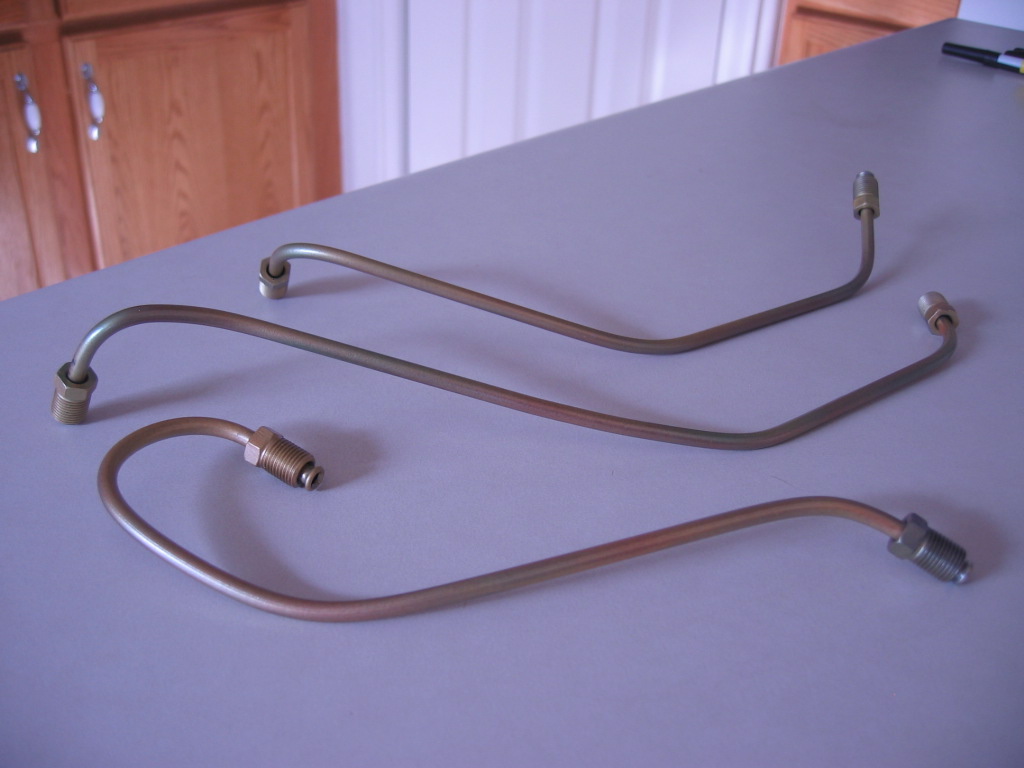

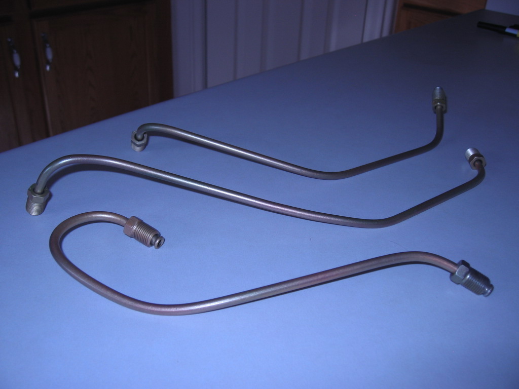

All in all I am happy with the way the parts turned out. The parts look good and you can't really tell it's not really cadmium plated unless you look close. It definitely made a difference in how things look under the hood of my Z. :knockedou

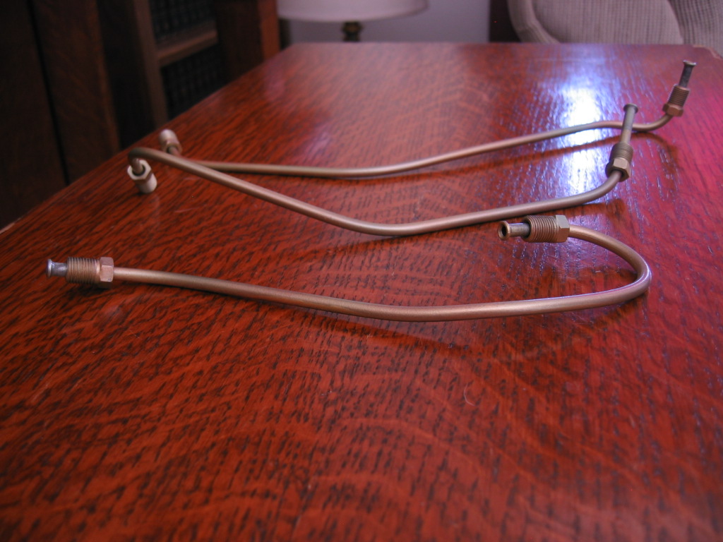

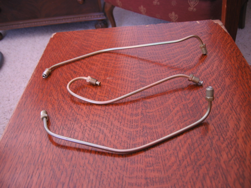

Here are a few photos of the small brake lines that were refinished.
Looks good, I too thought about replating my lines. But after finding out that the platers tank was only 5' wide I realized that I wouldn't be able to replate all the lines. So I opted for the some paint instead. As long as the lines are removed and done correctly they look good.
Thanks... Ken. Great Job. I ran into the same thing Ed did with the plater not having a big enough tank to handle the long brake and fuel hard lines. I ended up using VHT's silver caliper paint. It looks good and will hold up ...it just does not look like cad plate. I checked out the Eastwood sight. It contains a number of DIY products and systems that us restoration types look to outside sources for.

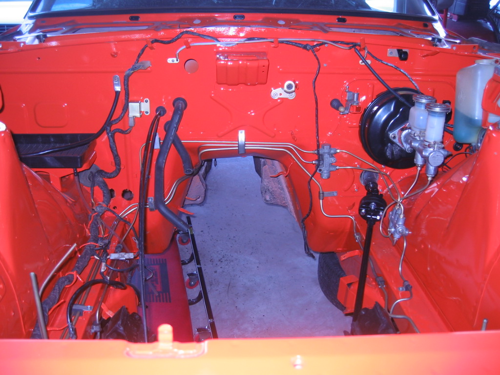

Here's how things looked before I put the engine back in the car.
