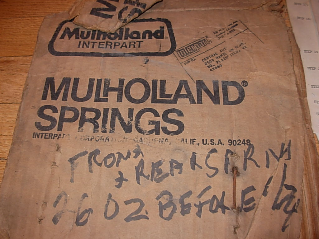

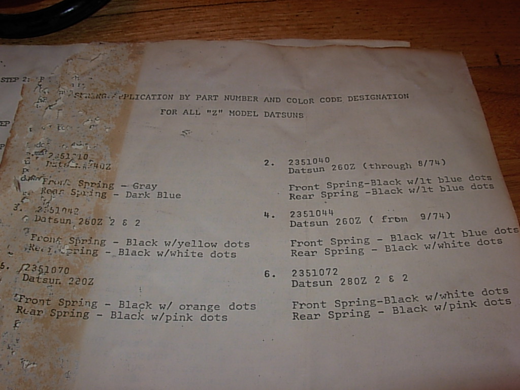

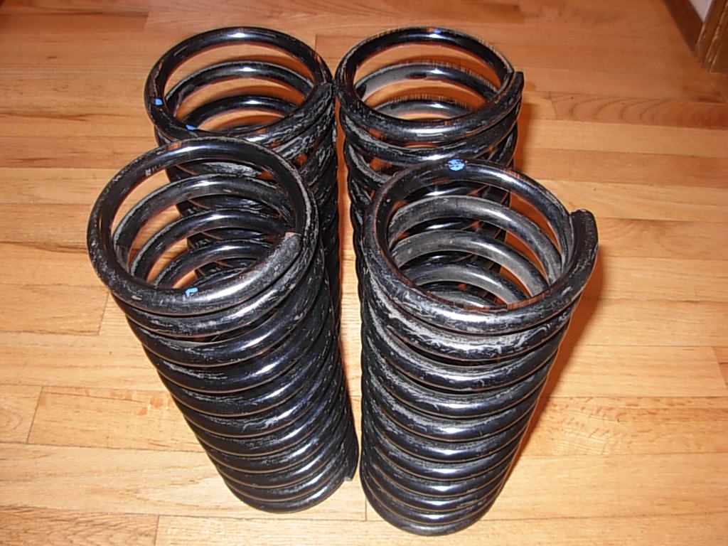

December 11, 200915 yr comment_302900 HLS30-30855 has the BRE springs - grey - front and blue - rear I don't know the spring rate though. I do have a question though - I cannot find my original installation instructions, but memory seems to recall the bump stops had to be trimmed shorter. Does anyone have information as to how much was cut off? I am replacing the bump stops (pretty well crumbled away over the years) with ones from MSA. As far a BRE springs. BRE did sell springs, but I do not recall them being color coded. The BRE (Mulholland) springs were color coded. I sold a NOS set for the early 260Z last year. The ones for the 240Z were color coded grey for the front and dark blue for the rear. I had a copy of the installation instructions, but I included them with the springs when I sold them, and I don't think I made a copy. I know that they didn't mention the specs spring rates though because I checked for that before I sold them. -Mike Link to comment https://www.classiczcars.com/forums/topic/18262-bre-yellow-spring-rates/#findComment-302900 Share on other sites More sharing options...

December 11, 200915 yr comment_302919 The BRE (Mulholland) springs were color coded. I sold a NOS set for the early 260Z last year. The ones for the 240Z were color coded grey for the front and dark blue for the rear. I had a copy of the installation instructions, but I included them with the springs when I sold them, and I don't think I made a copy. I know that they didn't mention the specs spring rates though because I checked for that before I sold them.-MikeHuge Thanks Mike for posting those photos! I have a set of Mulholland springs which I installed on my 280Z in 1978. I removed them sometime around 1980 and did not mark front and rear. I've wanted to reinstall them with a set of NOS Mulholland struts I found but was unsure on the springs. Now based on the colored dots I know my front from my rear :classic:Stan Edited December 11, 200915 yr by Z CAR 77 Link to comment https://www.classiczcars.com/forums/topic/18262-bre-yellow-spring-rates/#findComment-302919 Share on other sites More sharing options...
