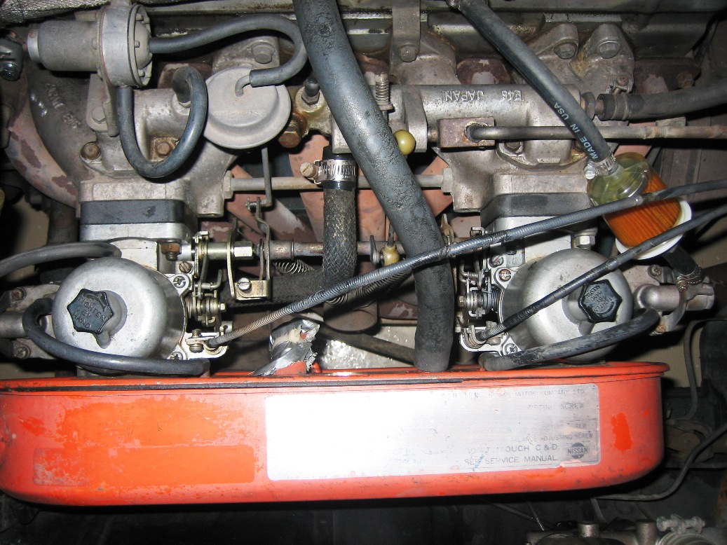

December 17, 200519 yr Author comment_149294 I believe I have the 4 screw variety. Here's a pic. Would fresh needles and nozzles remedy this situation where the screw to lean the mix is bottomed out? I am trusting this mechanic and he has done this forever but I hate not understanding it myself.... How much are needles and nozzles from Nissan? Less than the 150 for all the ZTherapy stuff in the kit? Link to comment https://www.classiczcars.com/forums/topic/18316-ing-emissions/?&page=2#findComment-149294 Share on other sites More sharing options...

December 17, 200519 yr comment_149304 Would fresh needles and nozzles remedy this situation where the screw to lean the mix is bottomed out? I am trusting this mechanic and he has done this forever but I hate not understanding it myself....In my opinion - no. It's possible, but I don't think it likely that the nozzles and needles are your problem. If the mixture is too rich with the adjuster screws all the way up, there is probably something else wrong. The main causes could be:The float level is too highThe nozzles are sticking (i.e. - as if the choke was stuck on)The nozzles are badly worn (needle orofices)The needles are badly wornThe needles are wrongThe needles are very badly adjusted (mounted way too far up in the piston, not a likely situation)Note that the fresh needles and nozzles only address numbers 3, 4 and 5. Number 1 will cause the same problem with new parts.I agree with Gary that considering your issue, you probably don't want SM needles, or even the early stock N27 needles used in the earliest cars, as those are the richest choices. N54s are probably your best choice for this, assuming you do get new ones.But I still strongly doubt that the needles and nozzles are the problem. In this situation the float level MUST be your first check. If it's too high, nothing else you do will help at all! Link to comment https://www.classiczcars.com/forums/topic/18316-ing-emissions/?&page=2#findComment-149304 Share on other sites More sharing options...
