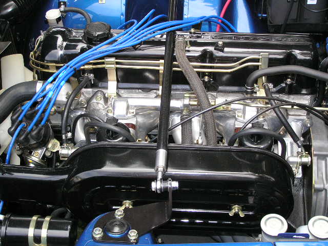

I've got a '73 with a balance tube from a '71. Everything plugged except the port for the PCV valve and the brake booster/automatic transmission kick down, which use the same port. The fitting screwed into the balance tube connects to the brake booster hose and has a tee for the transmission kick down hose.
Here are a couple of pictures for you.

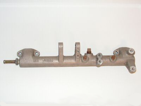

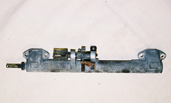

The E46 balance tube like this one is what we deal with most commonly in America as the casting provides mounting for emissions hardware. The vacumn tube comes off the end of mine. It is the early type. Later models of the Z have the vacumn tube takeoff on the top of the balance tube. The hose for the brake booster is different. Plugs for the vacumn line fittings are pretty easy to find. These are brass plugs.

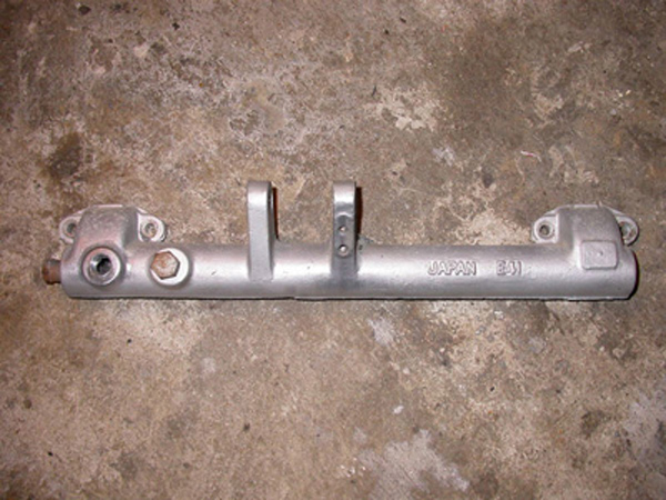

The E41 balance tube is what came on cars without emissions hardware. Here are two variants. One fits the vacumn line off the end of the tube and the other has fittings on top of the tube. It should also be noted that the hose fitting that screws into the manifold is machined for a restricted oriface.

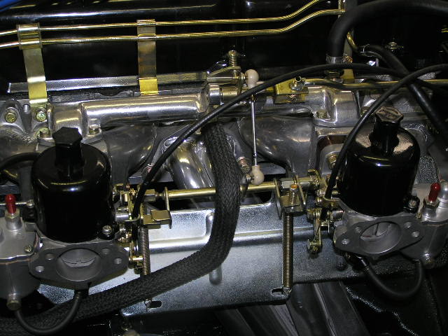

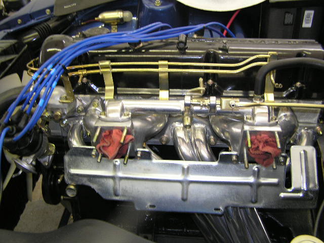

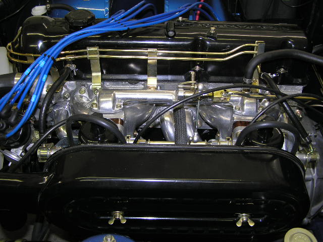

Here are some pics of my modified balance tube. We simply welded everything up and I ground her down to the minimum size and had her polished. It is like the European balance tube. I know they make vacuum lines for the tube end but the stock upper line is readily available. That is why I stuck with stock.
Hi Steve, weld away! Your initial post mentioned nothing about welding up the unused ports and polishing the intake & balance tube. Now I understand.
Loren, those pics of your engine, intake & carbs look fantastic! I really like the look of all that cad plating! Do the headers have that jet hot coat that keeps them shiny looking?
I got the headers from Motorsports. It is what they call "Aerospace Thermal Coating". It looks like it is chromed but stays that way after running. It looks just like it did when it came from them. I am impressed with this coating. It still looks good after driving the car 150 miles. They had a deal on these headers earlier in the year. I recommend this process.
Thanks for noticing the plating. If it wasn't plated or powder coated, it was painted.
