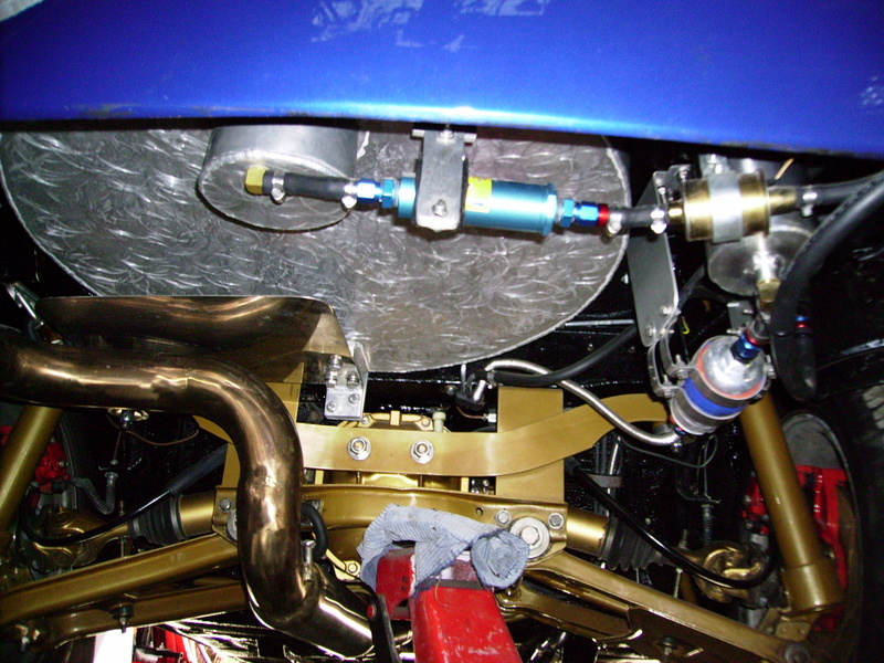

March 30, 200718 yr comment_204116 and to that, I'd like to add this picture, which is the same way Mine is set up, which I also figured out is WRONG...... Problem is that my driveline is significantly out of the tranny and leaks gear oil onto my exhaust pipe. I put the front R-200 diff mount in backwards and this caused the driveline problem. Now I need to turn the Mustache bar around, turn the diff mount around, and we're talking time well spent. Link to comment https://www.classiczcars.com/forums/topic/18452-mustache-bar-mounting-on-1170-z/#findComment-204116 Share on other sites More sharing options...
