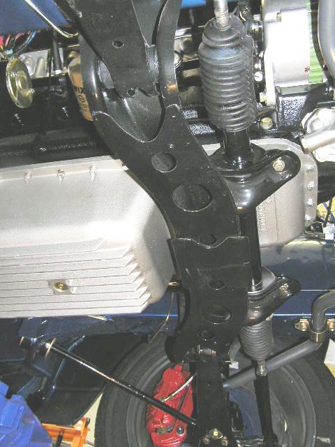

January 14, 200619 yr comment_152031 Yes! The crank scraper is only held on by the main bolts. I ordered this scraper for the LD28 crank but it had to be fitted to the "throws". I also use the aluminum pan with a nice set of oil gates. Link to comment https://www.classiczcars.com/forums/topic/18542-l28-pistons-120thou3mm-over/?&page=2#findComment-152031 Share on other sites More sharing options...
