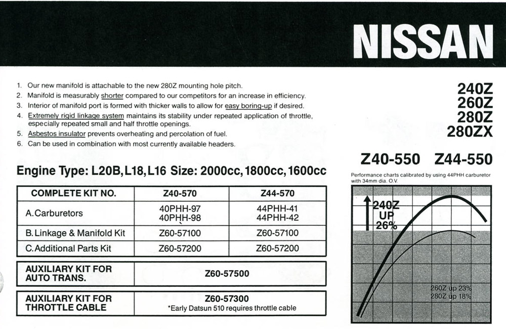

Wish I had a really good close-up of a Mikuni. Search the archives and I'll bet you find what you are looking for. The top of the carburetor body will say SOLEX in big letters, but it will also say Japan right below. Mikuni. I don't agree with you, Ez, that Weber is the weapon of choice. IMO Mikuni is the weapon of choice. Here is a blurb from the Mikuni catalog. Datsun competition sold Mikunis in both Japan and America. BRE / Interpart sold Dellorato.

Solex sidedrafts will have Mikuni markings as well as they are known as Mikuni Solex's that were available in several different sizes. 40's and 44's are hard to tell apart unless you know what you are looking for. 50's look completely different, and the bodies are made out of magnesium. You will want to measure the diameter across the back of the carburator 40mm=40PHH Mikunis / Solex carbs and up from there.
BRE sold Mikuni / Solex Carburators until they were bought out by Mac Tilton who changed the name of the company to Interpart and sold Dellorto's.
