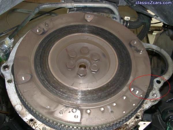

I used a bolt from the clutch and one from the starter. Then took a piece of metal (1/8th inch) with two holes in it (it was about 3 to 4 inches long) and screwed in one bolt to the flywheel then with the other hole I lined it up with the starter bolt and screwed it in. I didn't tighten the bolts all the way down. Then removed the fly wheel bolts one by one. This will keep it from spinning on you.
Exactly what I do :) :rambo:
I have a 1" piece of 3/16 steel with a hole in one end and pointed on the other. I use it for taking the bolts out and torquing them back on. (use it on on the left side for removeal and the right side for torque) I just put a tranny mount bolt through the hole and stick the pointing end into the ring gear. I have a thick washer under the strap to get it lined up properly. I have had this mechanism for 30 years and it works great every time. (KISS) It also works for removing & torquing the front balancer on the crank.
Do you really think you can zip a bolt all the way out of a high-pressure pressure plate with a torque wrench. Gawd, I hope not! Can you say 'warp' or 'cracked'? Flywheel, no problem but watch out for the clutch cover!
hope this helped you and you got the flywheel off ok. I ended up having to do this about 3 weeks ago. This way is alot easier than trying to hold the flywheel with a long rod or something of that short.
