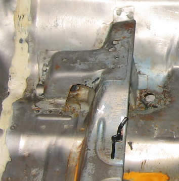

Hi Gregg, instead of cutting an access hole, you could probably accomplish what you want to achieve by using the hole that is there on the top of the mounting bracket. You might try making a dauber out of a bit of wire or a coat hanger and a small swatch of cotton. It should fit through that hole, and you could swab out the inside pretty well. There will be some areas you can't reach, but I'd think you could get to the backside of the seam along the floorboard. You should be able to bend the dauber to get to most of the inside of the bracket.

If you decide to go ahead and cut an access hole, you might consider using a hole saw. Get a round metal plug of the proper size from the hardware store to plug it up, put a little strip caulk around the edge, it will help seal it and prevent the edge of the hole from rusting. Or, use a rubber hole plug. I doubt cutting a small hole would compromise the structural integrity of the mount by much.
Hey guys, well I already cut and did the repairs I wanted to do on the reat seat mounts.
See the photos below for the progress.

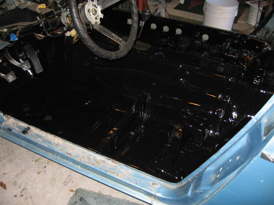

I used a dremel (went through three cutting wheels) one each. Then used wire brushes and the dremels small wire brush where I could, then a couple of rounds of metal ready and finally an arse load of Por-15 to seal it all. I am happy with the result. Now onto the underbody and wheel wells.
  kenz240z said:
Wow, from the looks of things, the floor pans will never rust out from the inside!
I am doing the same to the underbody when I get back from my trip. Two good coats of Por-15 topped with some Herculiner bed liner for extra protection. Since I am moving up to the great white north I want to make sure something I put this much time into will last.
