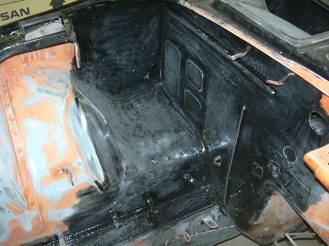

Oh and by the way I took Gary's advise - I washed it down with baking soda (neutralize acid) gave it a thorough water wash, removed all loose rust and two coats of POR. It's still a little on the ugly side, but it's got a "J" bolt through it holding a battery in place for the past 3000 miles and from recent inspection is holding good. The underlying fender although not pretty, turned out to be solid.

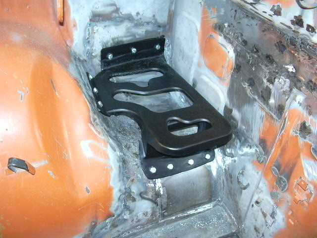

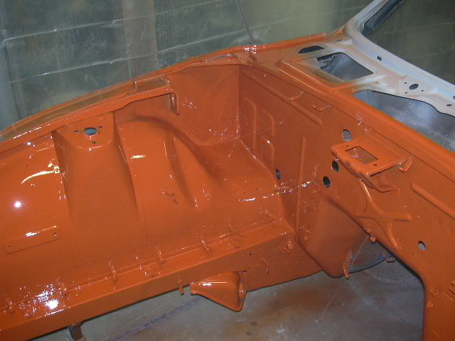

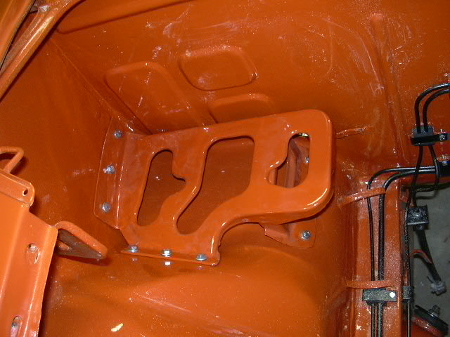

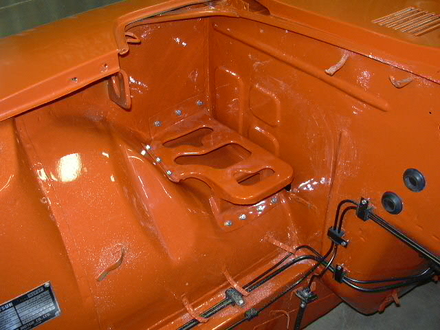

I put the paint on the fender under the battery tray. I will get all the wiring back into the car before I put the tray back. Nice thing about the bolt in arrangement.
Hey James, I've been saving your emailed photos in their own special folder - you should put them on disk as a tutorial on rust repair. Makes me almost feel like trailering my car over the mountains and back to the coast to get help on my battery area repair. Almost. Just got to get my friend the welder to come out of the hills to tackle this area. Otherwise I still haven't decided whether to replace my passenger floor pan. With some minor welding and some POR15 I think it will be okay.
