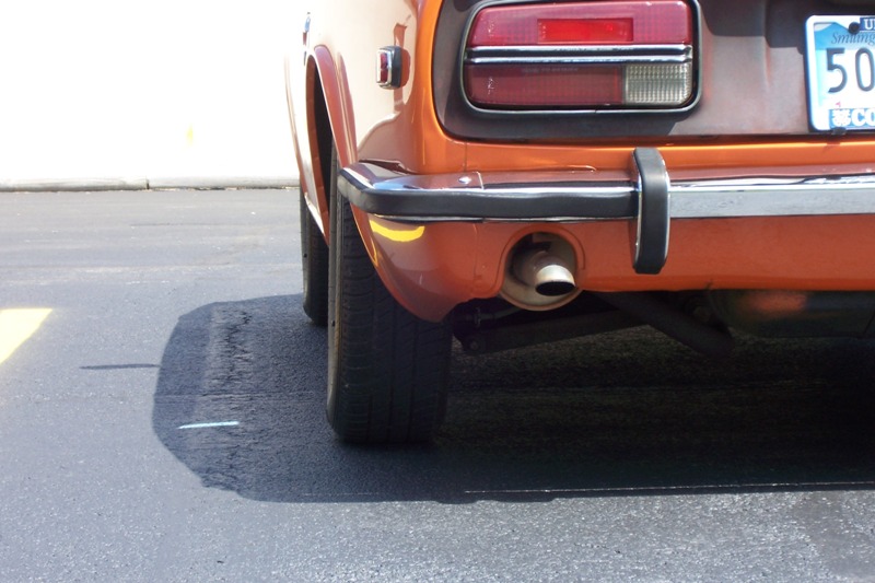

July 15, 200618 yr comment_174682 I installed the Eibach/HP combo a couple of months ago and I am quite pleased with the outcome. Comfy enough to me without compromising the "sport" in sports car. In fact now when I turn into a corner, like a left hand turn at an intersection, even just a little aggressive the tires start to squeel... guess I should get the 16" panasports now :devious: I do have a question for y'all though... Has anyone else noticed a substantial amount of negative camber in the rear after completing this upgrade? Here's a pic of mine. Link to comment https://www.classiczcars.com/forums/topic/18601-back-to-kyb-vs-tokico/?&page=4#findComment-174682 Share on other sites More sharing options...
July 15, 200618 yr comment_174683 I used MSA part number 23-4171, which is a rear camber adjustment kit, to get the rear alignment back in spec. Link to comment https://www.classiczcars.com/forums/topic/18601-back-to-kyb-vs-tokico/?&page=4#findComment-174683 Share on other sites More sharing options...
July 15, 200618 yr comment_174685 Awesome! Thanks Stephen.Nate Link to comment https://www.classiczcars.com/forums/topic/18601-back-to-kyb-vs-tokico/?&page=4#findComment-174685 Share on other sites More sharing options...
