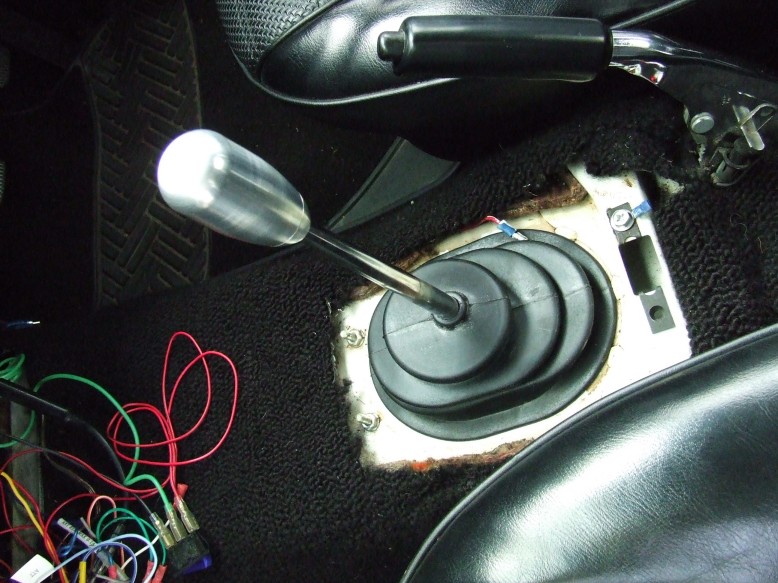

March 16, 200618 yr Author comment_159470 Not over till the fat lady sings, with centre console installed. Here's the latest - a NOS inner rubber boot from Japan! Could not find one even 2nd hand in Australia so with my good friend Miles' (sakijo) help we organised this! Fits perfectly, looks great and now it's a LOT quieter inside! Thanks Miles :laugh: Link to comment https://www.classiczcars.com/forums/topic/18626-auto-to-manual-conversion-guide/?&page=5#findComment-159470 Share on other sites More sharing options...
March 16, 200618 yr comment_159479 And a metal shift knob to boot ! Link to comment https://www.classiczcars.com/forums/topic/18626-auto-to-manual-conversion-guide/?&page=5#findComment-159479 Share on other sites More sharing options...
March 16, 200618 yr comment_159484 Thats a nice knob you have there young man! Link to comment https://www.classiczcars.com/forums/topic/18626-auto-to-manual-conversion-guide/?&page=5#findComment-159484 Share on other sites More sharing options...
March 16, 200618 yr Author comment_159504 Yeah it's nice, fits nicely in the palm of your hand. About 2" in size. It's the exact same shape as the original knobs, but in metal. Now I just have to source a outer gearboot. Will just try to get one made up at a local auto trimmers, otherwise back to Yahoo Japan I go! Link to comment https://www.classiczcars.com/forums/topic/18626-auto-to-manual-conversion-guide/?&page=5#findComment-159504 Share on other sites More sharing options...
