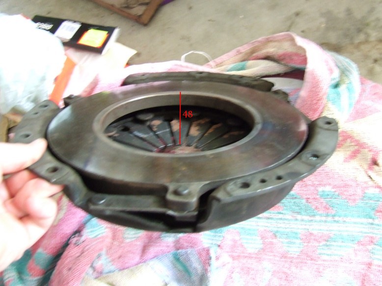

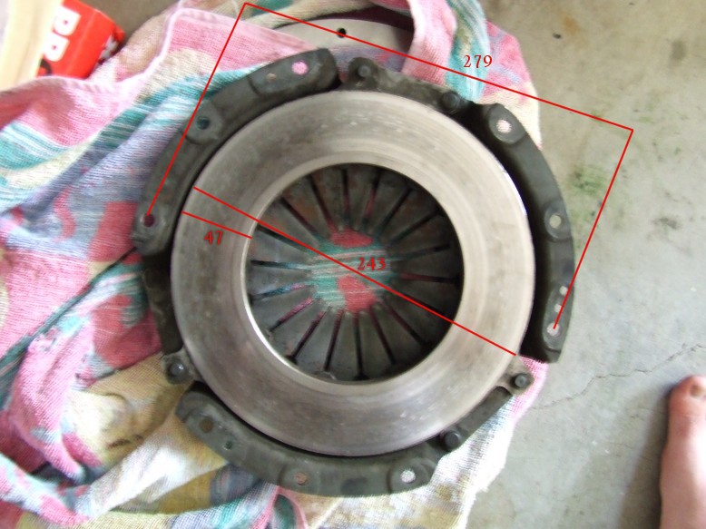

This is the clutch that came out of my parts car. It is a larger overall diameter and thicker than the standard 240K clutch... so my question is, what is it!?

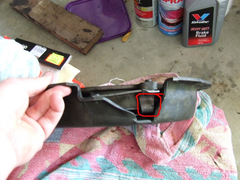

At Repco they now have 2 clutches we think could be right. They're so damn similar though... a S14 200SX Silvia clutch and a 280ZX clutch. Surely it's got to the the 280ZX clutch? However, it's a little bit different to this one. The biggest difference is the side - it's missing the bit I have circled in red. The 200SX clutch has this bit though...

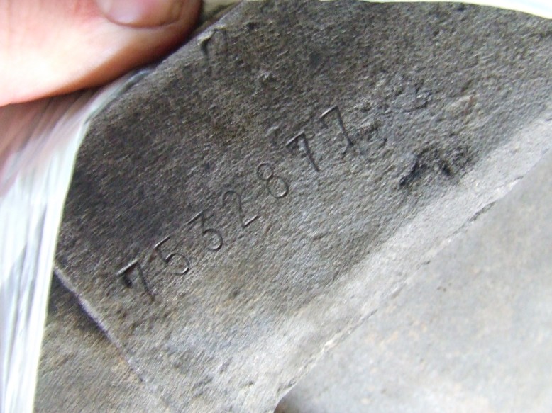

I just don't know. I would hate to get a clutch to find it not the right one at all and just waste $200 odd. I am leaning towards the 280ZX purely because it would make more sense. I have also included a picture of the number on the gearbox if that helps - dont think so.
Cool, thanks Victor and Michael. Can anyone shed light on the small part I circled and what its purpose is? And why the new one doesn't have it?

As long as the new replacement clutch assembly is the same diameter and height as the one that came out, all should be sweet. I'd ask for specs on the 2 clutches, and use whichever is the heavier clamping force (assuming that the 200SX one bolts up to the flywheel).
