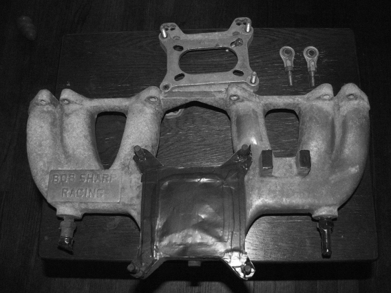

January 26, 200619 yr comment_153477 Funny you should mention the intake. I have just finished sealing all the openings on this one so I can polish it up a bit without getting any abrasives inside. This one includes what looks like a 2 bbl adaptor. Not sure what I will do with it yet. Have SU's and downdraft Webers at my disposal. Have not seen too many of the Bob Sharp one's around. Looks very similar to the Arizona one. Did some google research on Bob....kind of interesting. I think you will find both people praising and bashing it here on this site, but I found some ancient info on the web a while back speaking highly of it. Not sure of the value though....sorry. Link to comment https://www.classiczcars.com/forums/topic/18682-bob-sharp-racing-4bbl-intake-holley-carb/#findComment-153477 Share on other sites More sharing options...
January 26, 200619 yr comment_153478 Oh yeah.....here ya go.http://www.datsunhistory.com/Sharp.html Link to comment https://www.classiczcars.com/forums/topic/18682-bob-sharp-racing-4bbl-intake-holley-carb/#findComment-153478 Share on other sites More sharing options...
January 26, 200619 yr comment_153505 Arizona Z-Car is making these intakes as well. Link to comment https://www.classiczcars.com/forums/topic/18682-bob-sharp-racing-4bbl-intake-holley-carb/#findComment-153505 Share on other sites More sharing options...
January 27, 200619 yr Author comment_153617 Hi Zthing, thanks for the info. The 240Z I looked at had the same intake as shown in the picture you posted.Thanks for the link on Bob Sharp, I'm still learning about the proud racing history of the Z car. Link to comment https://www.classiczcars.com/forums/topic/18682-bob-sharp-racing-4bbl-intake-holley-carb/#findComment-153617 Share on other sites More sharing options...

January 28, 200619 yr comment_153756 I am no authority....not even close, but it seems from what I have read the Sharp, Arizona, etc. intakes were in fact preferred by some over the later flat-top SU's. These aftermarket intakes seemed to have been most commonly found on the 260z. My opinion is still out on all the 90 degree comments. Seems no matter the carb, the fuel still has to make that horizontal run to the head. At least the top feeding carb gives it a good gravity induced pat on the back. At any rate as stated before, everyone has an opinion. I think it all depends on your particular application. Best bet, talk to someone that has in fact utilized this type of set-up, and installed it correctly. There must have been a market for them at some point.....companies don't usually continue manufacturing parts like this where there is no demand. Oh....by the way.....I think you mentioned test driving the car.....and your comment was that it was fast. The intake must work fairly well I guess. Link to comment https://www.classiczcars.com/forums/topic/18682-bob-sharp-racing-4bbl-intake-holley-carb/#findComment-153756 Share on other sites More sharing options...
