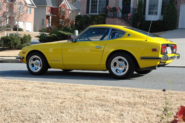

One of the reasons I am considering different wheels is due to the fact that I would eventually like to upgrade the brakes and my options are somewhat limited with the 14's, as well as the fact they are only 6" wide. Anyway, I've got some other things to do in the meatime.
Remember that any +12 offset mags won't fill the guards out as nicely. Even with 235's on there it still sits in. Plus the 14 inch tyres aren't as available anymore. (Well around her anyway)
My 280zx 6spokes sit pretty close to the stock brake calipers, so I don't know how they would go after an upgrade. The Jellybeans look good, but they will always look dated on the car, especially in 14 inch.

I have 4 goals. 1)find something different that not everybody has, 2)move to 15"s so I have more tires to choose from, 3)fit some bigger tires in there, and 4)allow enough room to fit one of the 3 versions of the Toyota caliper brake mod. I believe'81 280zxt wheels will allow me to accomplish #1&2. I'm not so sure about #3&4.
Yeah, I guess they are a bit heavy but I really like them. Until I find something I like better or these won't help me meet my goals, they are the ones I'm after for now.
Ok, go ahead and talk me out of it. ;)
