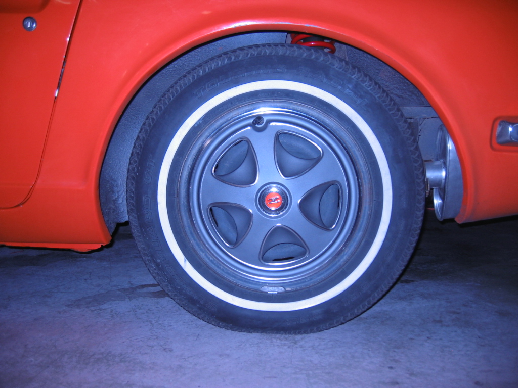

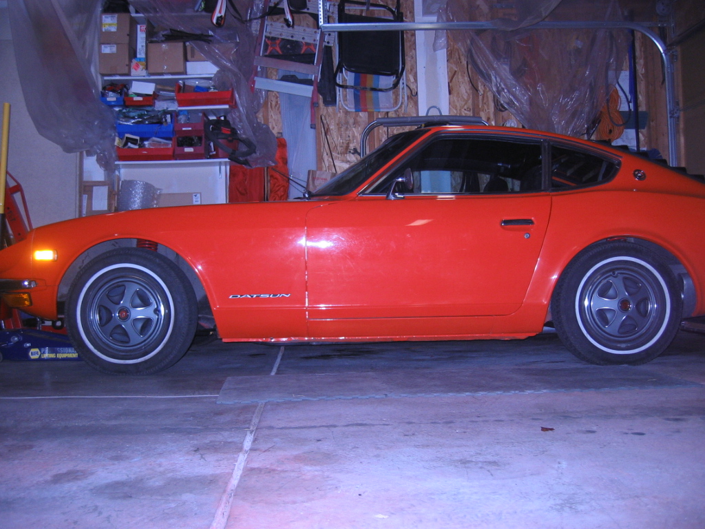

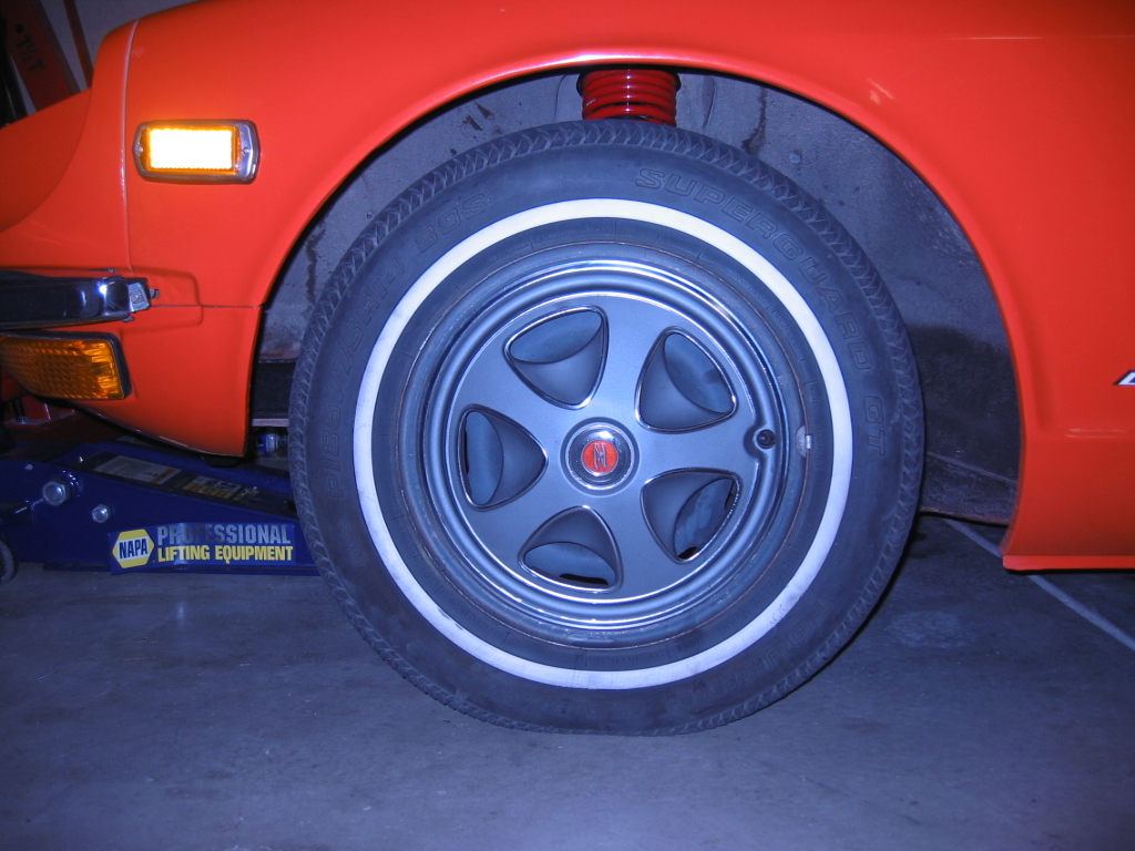

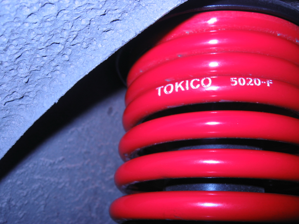

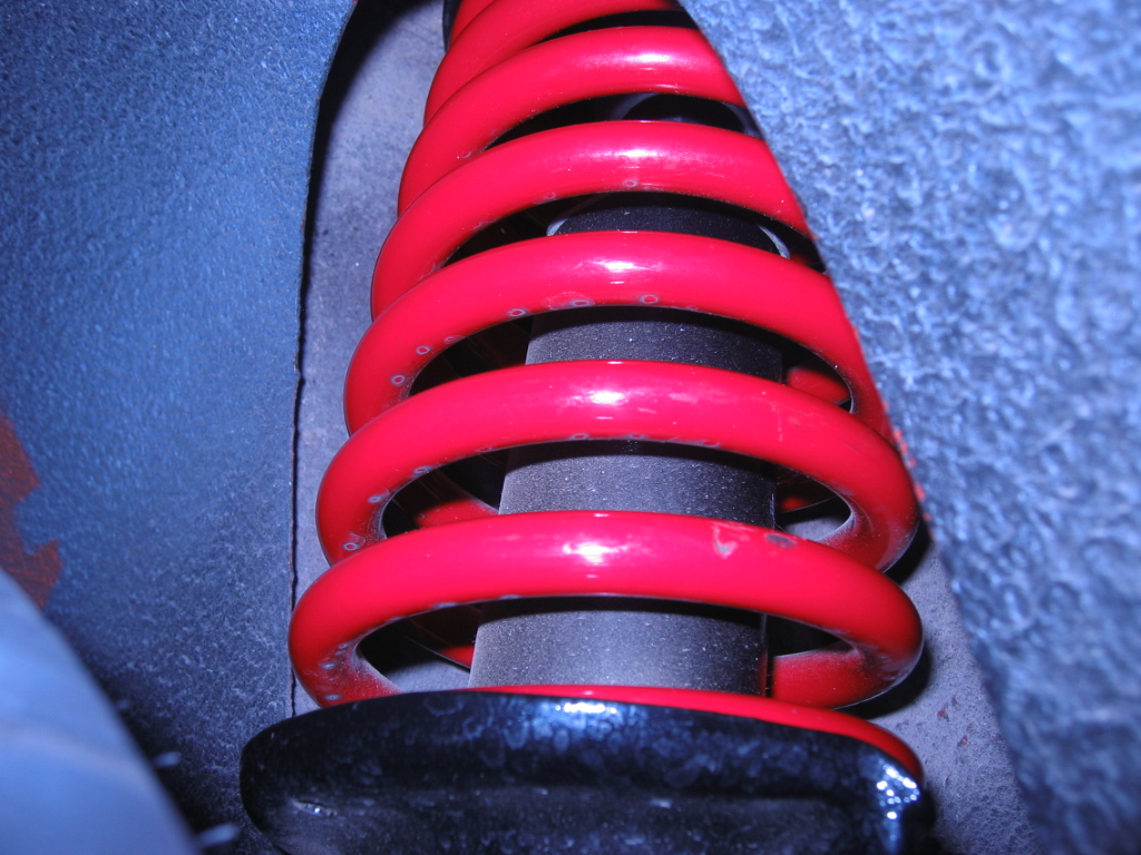

February 1, 200619 yr comment_154235 Speedgato, Here are some shots of my Z, it has the Tokico blue HP struts and Tokico springs that came as a package deal. The fronts are labeled 5020-F as shown. The rears are 5020-R, but the label isn't visible in the photo of the rear spring. As seen in the other photos, the front is a bit higher than the rear. I've got taller tires on the original steel wheels, they fill up the wheel wells a bit more than yours. Link to comment https://www.classiczcars.com/forums/topic/18725-rear-and-front-reversed/?&page=2#findComment-154235 Share on other sites More sharing options...
February 1, 200619 yr comment_154251 Yipes, what a rake, David! A scary look for a Z car! Please say it ain't that way no more!!! IT AIN'T THAT WAY NO MORE!!! The Z in my avatar is the same car! I also have the Tokico Springs and struts in it and it sits pretty level. I had to replace the rear strut tube assy do fix it tho. Link to comment https://www.classiczcars.com/forums/topic/18725-rear-and-front-reversed/?&page=2#findComment-154251 Share on other sites More sharing options...

February 2, 200619 yr Author comment_154376 I dropped the suspension today....Yep, they are reversed! I had thought that they were all rears until I was able to actually get them out. They are TOkico's also, 5020-f & 5020-r. THey are now in the right locations. THanks to everyone for all the help!! Link to comment https://www.classiczcars.com/forums/topic/18725-rear-and-front-reversed/?&page=2#findComment-154376 Share on other sites More sharing options...
