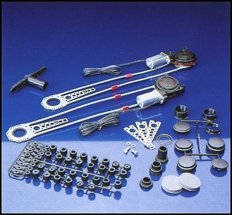

February 2, 200619 yr Author comment_154443 The kit that I am getting, eliminates the window crank. No cutting, welding or ripping into the door. I can remove the kit and put everything back to stock when I'm done, with the exception of the door panel. Which only has to have the hole for the window crank, hogged out a little for a snap-on cap. The P.W. kit uses small gears that attach to the window crank rod, which requires the removal of the handle. I have installed this kit in a 240Z before but did not document it. Here is a picture of the kit.....and the switches..... Link to comment https://www.classiczcars.com/forums/topic/18750-power-windows-in-a-70-240z/#findComment-154443 Share on other sites More sharing options...

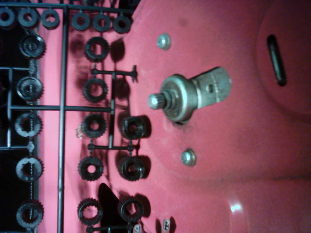

February 3, 200619 yr Author comment_154494 Zedrally said: What do you do with the window winder?Just wondering? What do you mean by "window winder"? If your talking about the window handle or crank, You nicely put it in a box after cleaning and set it aside for who ever wants to pay the most...... If you're talking about the black "T" shapes handle in the first picture, That goes in the glovebox for emergencies. The kit has many depth options on the gear drive adaptors long one for long shafts or mid or short (I used the shortest one) Here are the first pictures.. Link to comment https://www.classiczcars.com/forums/topic/18750-power-windows-in-a-70-240z/#findComment-154494 Share on other sites More sharing options...
