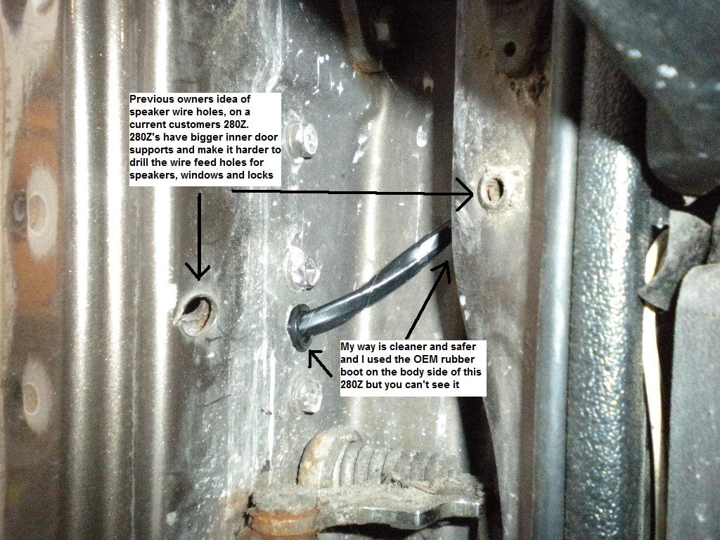

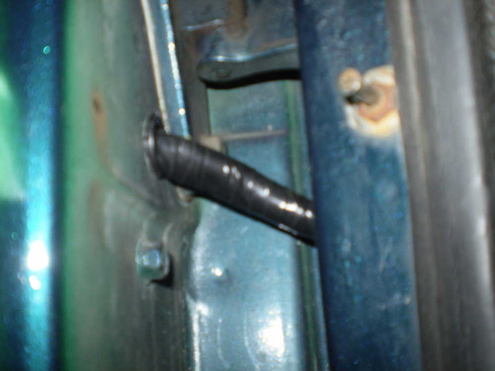

Hi, I´m looking into installing power windows and door locks on my 1973 240Z. I was just wondering what´s the best way to route the wires from the door and into the chassis? Also how to keep the wires safe from water and grinding against the chassis?
I use a small drill inside the door with a 3/8" bit or even a step bit up to 3/8" Then I use a 3/8" grommet. On the body side, I like to drill the 3/8" hole through the hole in the kick panel that the hinge bolts are in. And as close to being across from the hole you drill in the door. If you need to, drill through the sheet metal into the pocket then to the outer sheet metal. It's hard to describe without pictures.
And as many times as I've done this to an S30, you'd think I'd have a bunch of pictures by now.
Dave
