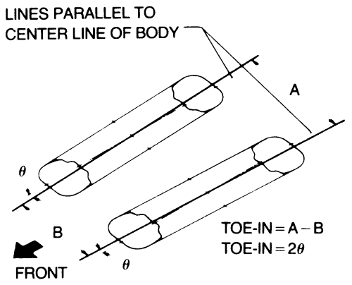

Here's a couple of images to help you out. The first shows the tie rod end and the lock nut you'll need to loosen to make the adjustment.
The second explains how to determine the toe setting. While on the ground under it's own weigh, place marks on centerline of the front tire, both the forward and rearward facing portion of the tread. Then use a broom stick or something else you can make a mark on to measure the distance between the marks and do the math.

Toe in the front is pretty easy to set. Most of the tires I buy have a center tread lug. I just hook a tape measure on the center tread lug front and rear and measure as high on the tire as I can without hitting the frame or the suspension with the tape. Do that front and back. Good street toe setting is 1/8" total toe in.
Move each tie rod evenly and have someone hold the wheel straight so that it remains straight after you adjust it. That's pretty much it.
