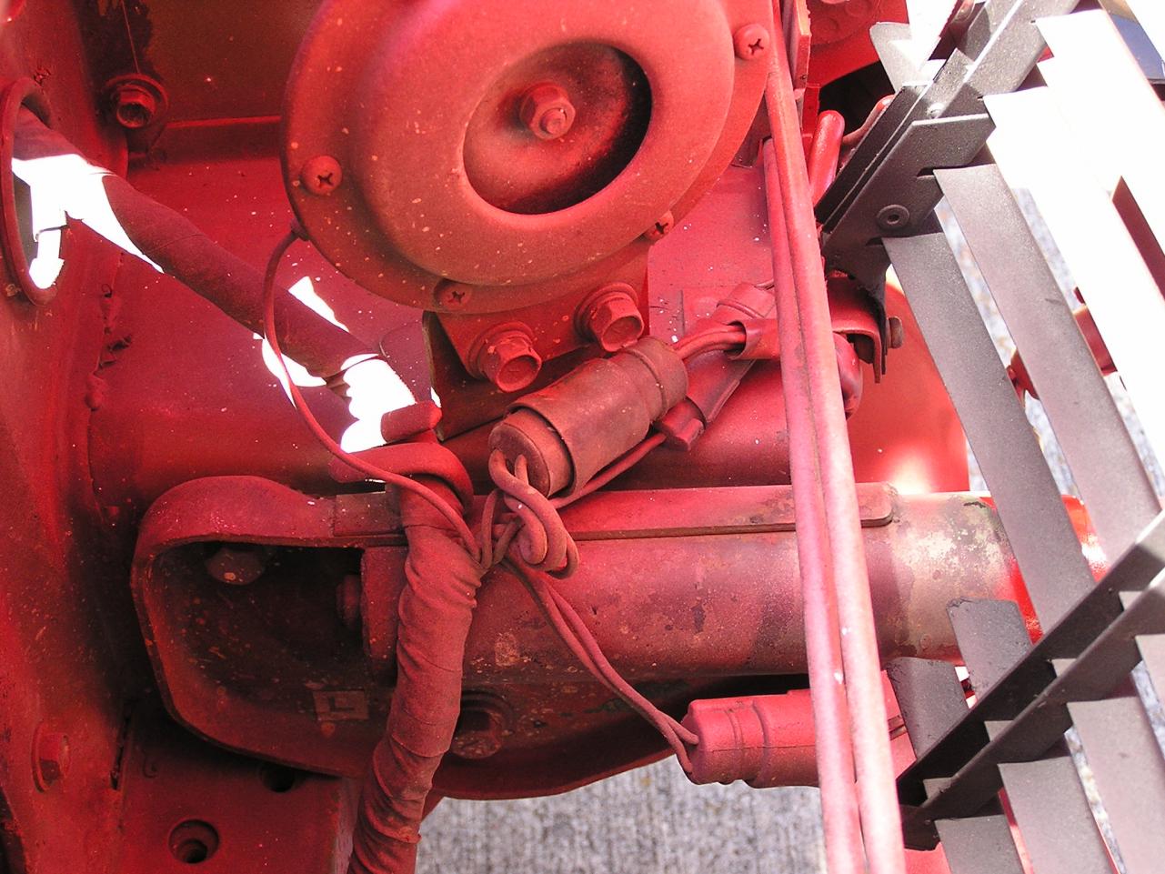

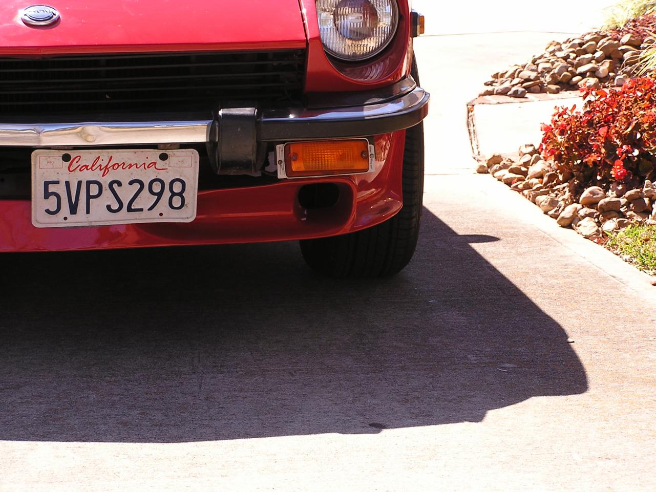

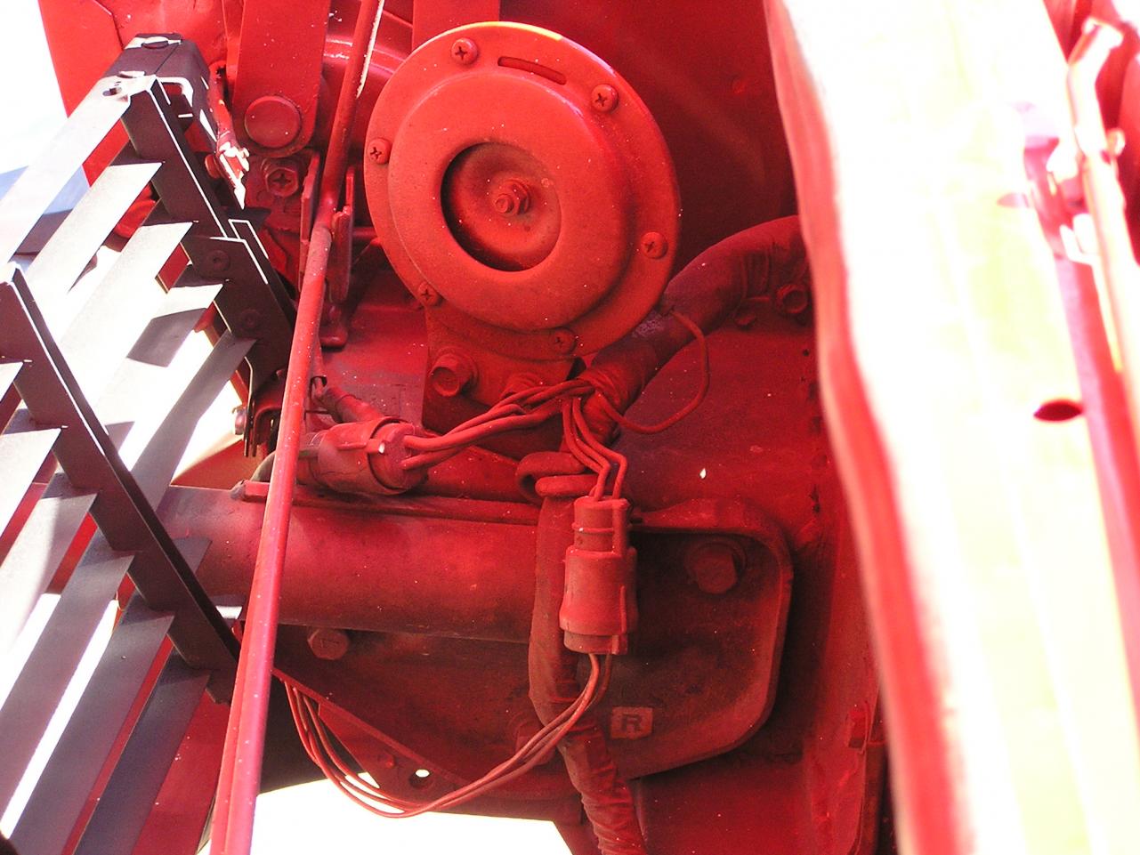

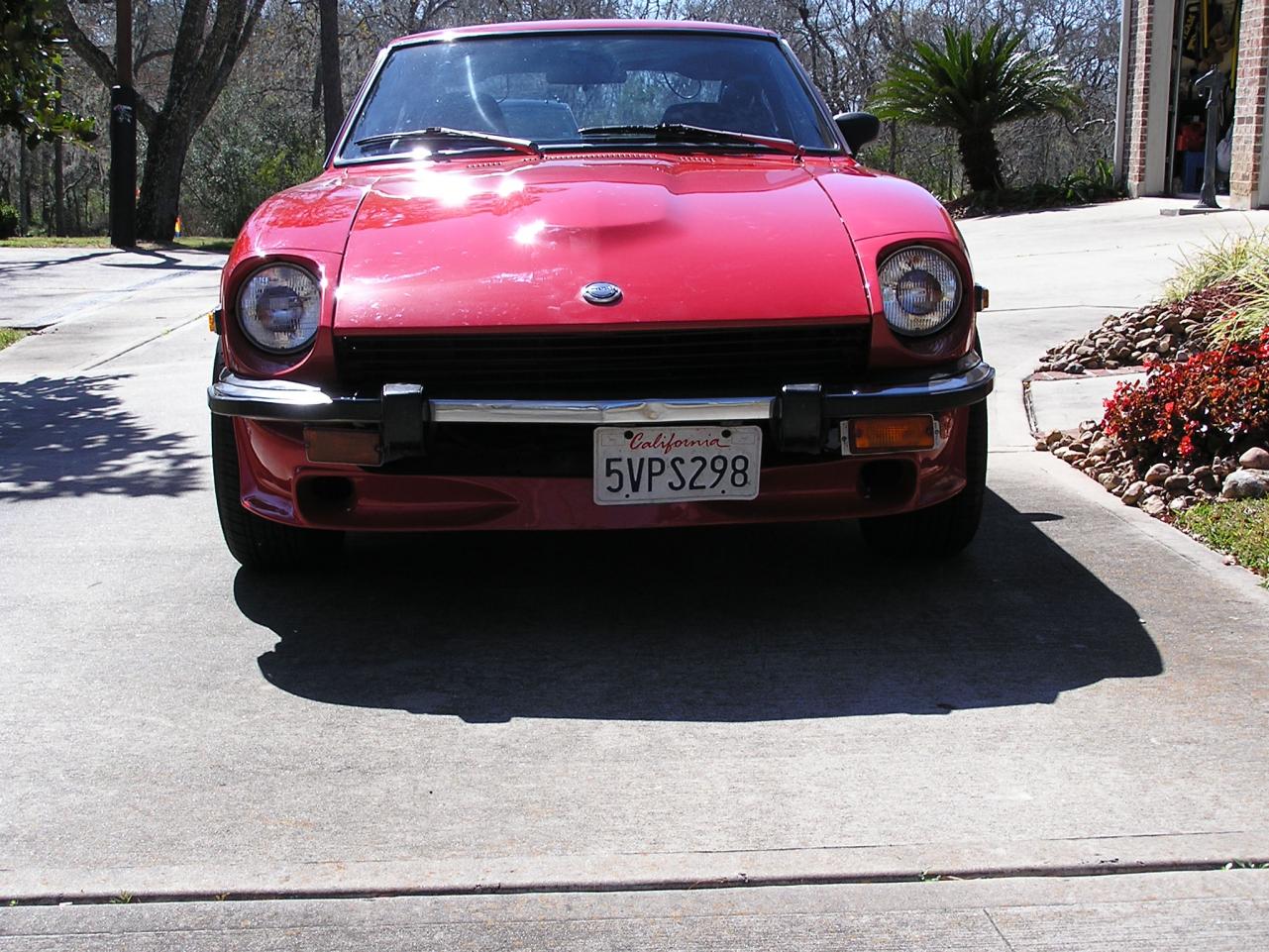

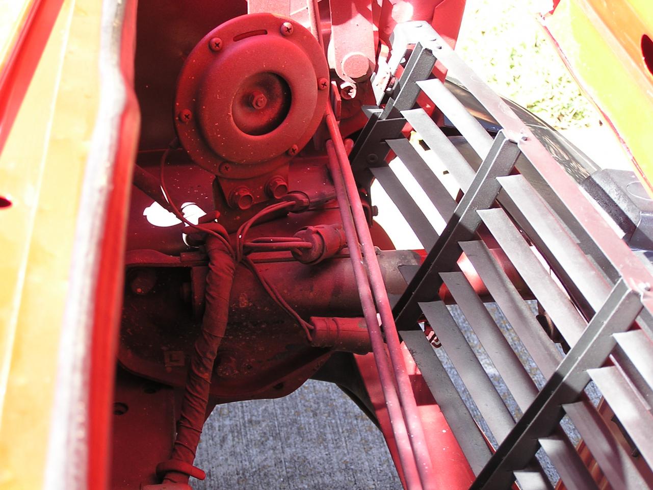

Dave:
Well I BELIEVE the connectors are black.
The previous owner did a great job with this car except in about four places
1. The front light hook ups with the bumper and what I believe is a 280 air dam. I will likely change thse out for some lights
that are better looking and at least match the lenses.
Do you have any suggestions??
2. The overspray red into the front area as you can see. GRRRRR!
3. Cruddy aftermarket igntion.
3. He did not go ahead and take off these crappy flattop carbs and replace them with triple Mikunis for me ROFL!
Then what would I have to do????
The best I can tell they are black under the red. The car is manufactured in August 1973 and of course is a 1974 260.

Yup, that's a late 260Z early to late 280Z spoiler. You're supposed to have a 240Z spoiler and lower marker lights like mine. Easy fix would be to buy the correct spoiler and new or used (more likely) lower lights. Couple hundred for the spoiler and lights together.
Those ARE black connectors under the red paint. Read your PM after I'm done with this post.
