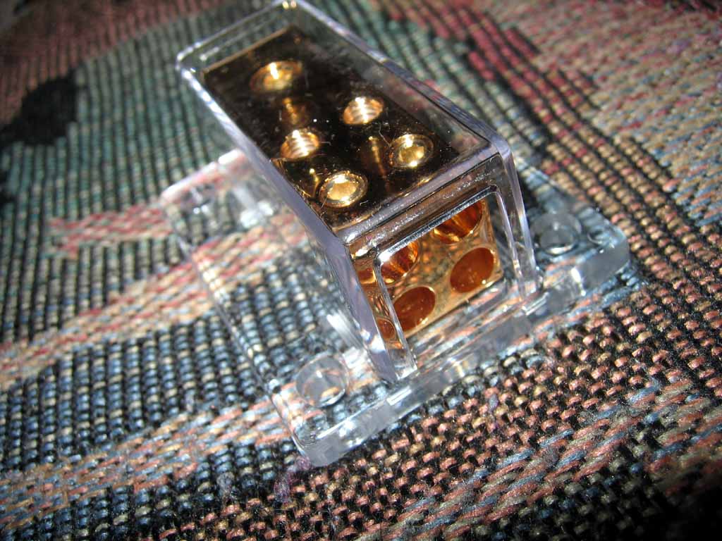

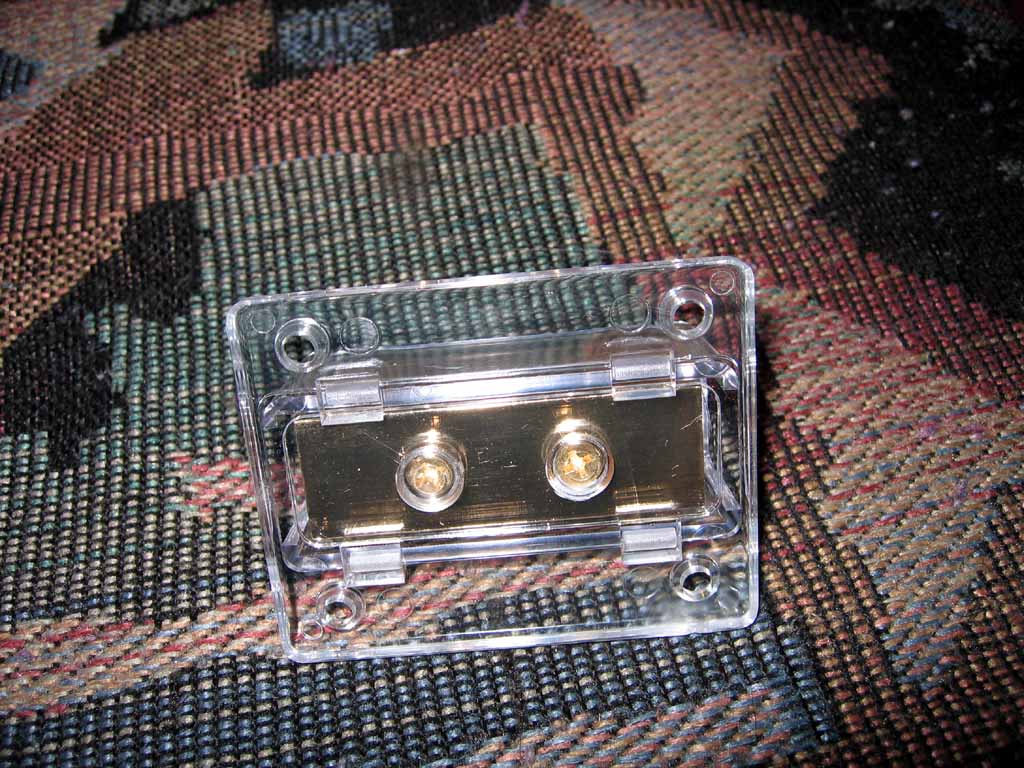

March 15, 200619 yr comment_159392 I agree with Dtsnlvrs....Having 2 attachments to the positive terminal, AND wanting to have my new stereo cd player head unit connected directly to the battery would have me jamming 3 extra wires!So I went to a stereo shop (got my stereo at Walmart, I'm a cheap arse--but it is a nice 50w x 4 mosfet mp3 compatible Pioneer head I paid only $130!!!) and the stereo shop sold me a 1 into 3 gold plated attachment...all have a screw that you tighten to secure each wire into the block, it looks great. Waterproof with a plastic shielding cover. They were quite helpful, and said that this block is normally placed inside the cabin and used for amplifiers only. They said it would have no problems with the configuration I wanted--just that I need to use 4 gauge wiring instead of their normal 8 gauge they use for the live feed for amplifiers. The hole that the live cable goes into fits a 4 gauge wire perfectly as well.The live wire feed is big enough for 4 guage wire, so I bought a 2 foot length of wire so I'll only have 1 extra 4 guage wire. So what I'm going to do is mount this little contraption next to the battery on the firewall where there is a nice little space with enough room for wires on both sides...4 gauge wire goes into block on battery side; on the other side, I have a live feed for the stereo head (still have presets, etc. hooked up to cigarette lighter)...the other 2 holes are used for Dave's headlight relay and the parking light relay.I'll post pictures as soon as I have it assembled.PS. I just ordered a brand new 92 Honda Civic blower fan, from www.drivewire.com, an online auto parts supplier. Direct Link:http://www.drivewire.com/hondaparts/catalog/hondacivicheaterblowermotor.htmlThe total cost with free shipping was $85. I thought this was a good deal, considering that this is a major everyday item that I use quite frequently with Oregon's chilly wet winter weather. Can't wait to see the difference!!! (apologies right now if you didn't want me to change subjects...I thought with the electrical improvements being the major subject of this thread everyone would be interested.)Everyone have a good week, Link to comment https://www.classiczcars.com/forums/topic/18838-headlight-upgrade-harnesss-for-sale-again/?&page=7#findComment-159392 Share on other sites More sharing options...

March 17, 200619 yr comment_159668 David, Check out the pictures of the block I bought; it's for amplifiers at a car stereo shop, but should do the trick. I'm mounting it near the battery on the firewall in the engine compartment. On the big hole side, a 4 guage wire from the battery is going; on the other side your headlight harness and your parking light hardness are going to get their electricity. I'm also hooking up my stereo (just a head unit, low wattage). Tell me what you think; also, I know, the holes might be too small; if they are, I'm just going to drill them a little bigger. Link to comment https://www.classiczcars.com/forums/topic/18838-headlight-upgrade-harnesss-for-sale-again/?&page=7#findComment-159668 Share on other sites More sharing options...
March 17, 200619 yr Author comment_159673 that'll work great! It looks like a 1-4 gauge in and 4-8 gauge out. The biggest wire I have on a harness is 8 gauge on the HLH w/ foglight attachment.You can even put both harness's power wires into one of the four holes if you want.Dave. Link to comment https://www.classiczcars.com/forums/topic/18838-headlight-upgrade-harnesss-for-sale-again/?&page=7#findComment-159673 Share on other sites More sharing options...
March 17, 200619 yr comment_159769 Yeah, I think it will work great....I'll have 4 guage on one side from the battery, and 8 guage on the other side for your headlight harness, the parking light harness, and a live feed for my stereo decks power.I don't have a garage however, and I'm going to wait until this Portland, Oregon weather gets better....its been rainy and pretty cold outside....not the kind of weather I like to be out in for a few hours doing a dexterious task like wiring on my car....supposed to warm up next week so we'll see. Link to comment https://www.classiczcars.com/forums/topic/18838-headlight-upgrade-harnesss-for-sale-again/?&page=7#findComment-159769 Share on other sites More sharing options...
