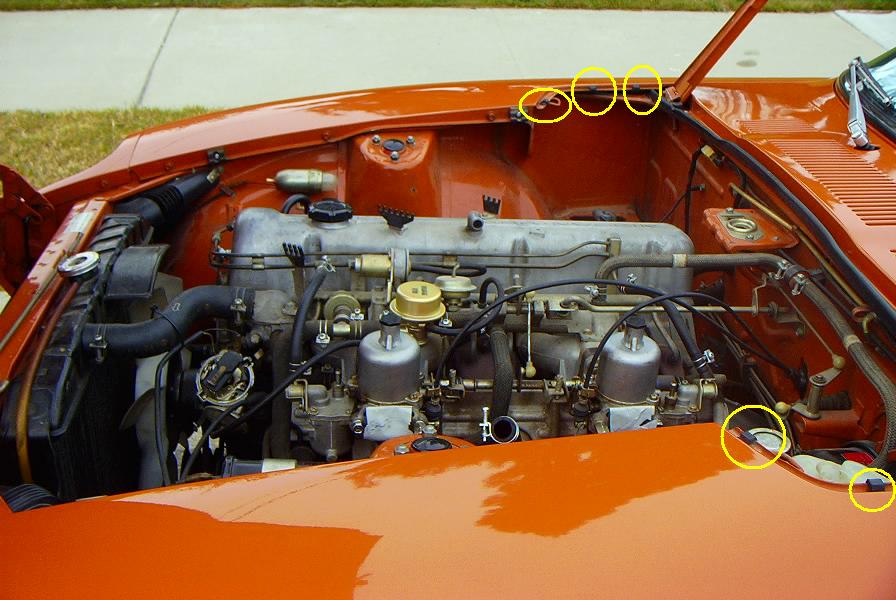

I tooks this shot before I had the engine steam cleaned. I circled my inspection bumper locations in yellow. I believe the placement is correct...given the car hasn't been repainted (yet).
Hey thanks, that was quick. That car looks nice for original paint.
There is a 2' X 1/2' long flat rubber piece that I got also. I guess it goes on top of the lid to cushion the against the hood.
Thanks
There is one shorter piece of rubber that goes on the top edge of the radiator support, and the other one longer one along the firewall where the back of the hood is.

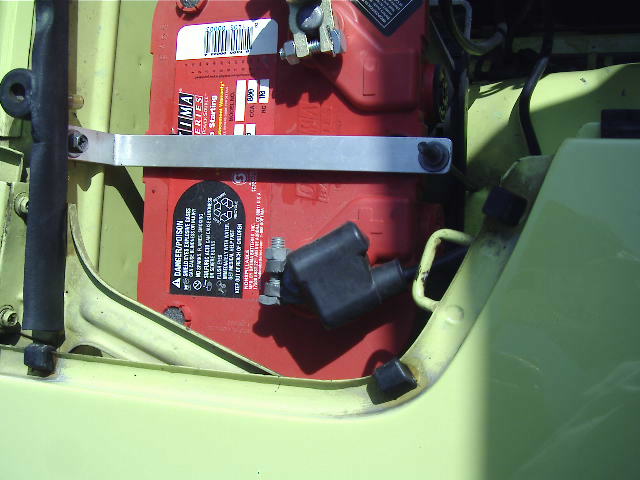

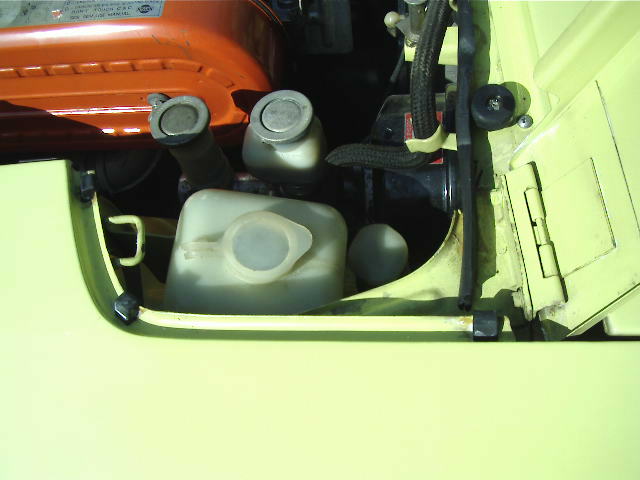

The only inspection lid rubber that I have on my 72 is the rectangular piece, this goes on the flat area of the inspection lid that the main hood falls over, it actually is the only area wide enough for the piece of rubber.
I've never seen those rubber pieces that DatsunZGuy has circled...my car never had them when it had original paint...manuf 10/71. but they look like I should have them.
I don't think the 240Z has the one on the edge of the radiator support. IIRC they don't even have the raised lip there where it would be on a 280Z.
The 1973 Datsun 240-Z's had the raised lip and rubber seal on the front radiator core support.
