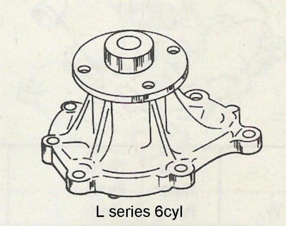

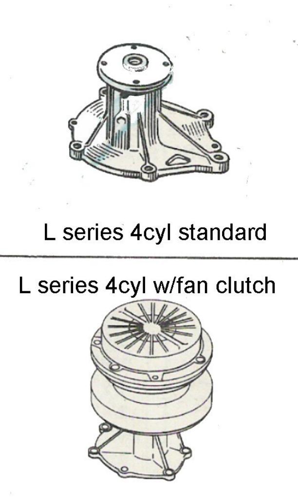

My water pump croaked yesterday and a friend has offered me a second hand one of a 4cyl L18. Does anyone know if they're the same as an L24 pump?
Get a new/rebuilt pump. The 4 cyl one wouldn't work anyway. Most of them had a built in fan clutch but even the ones that don't would not allow you to used the Z fan clutch. Different bolt pattern where the clutch mounts.
